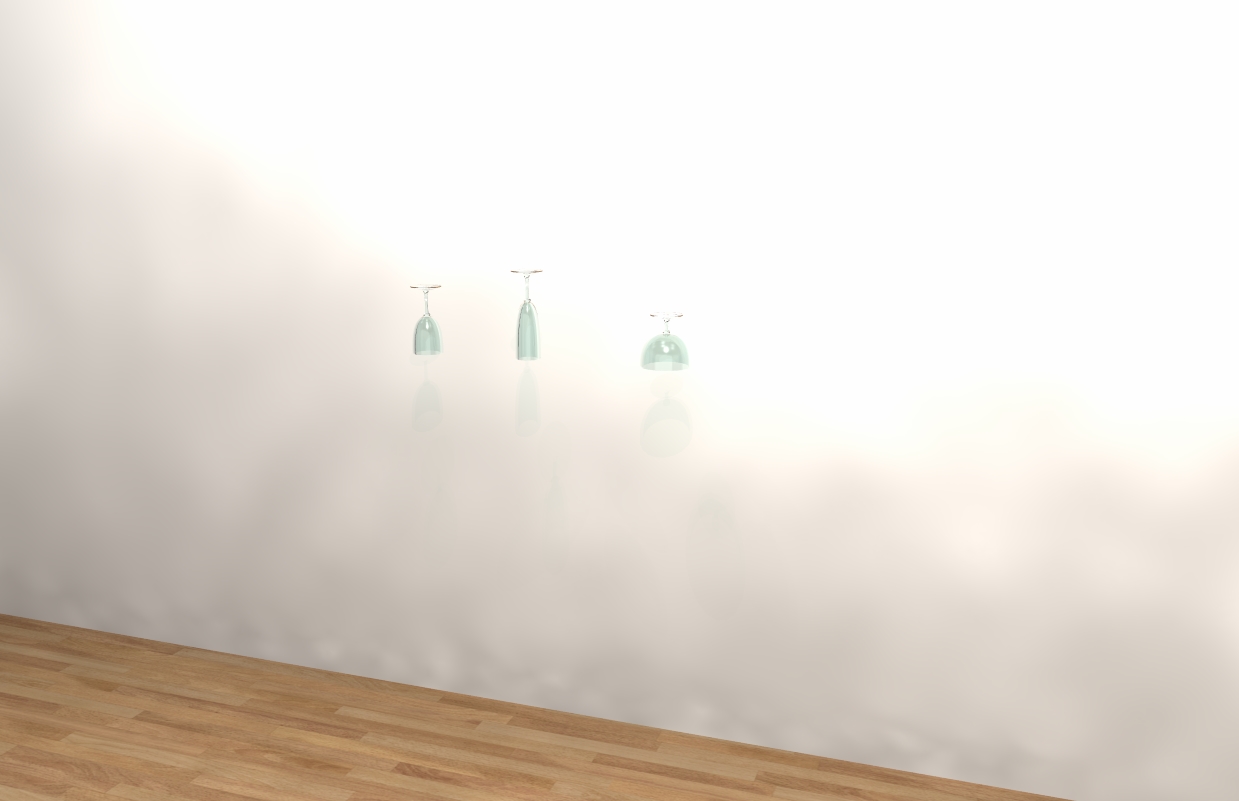

All,
Is it now possible to flip a wine glass upside down to show in a stemware rack? I don’t see any like this in the cloud images.
June 10, 2019 at 4:48 pm #240408Neil WilsonParticipant
Hi Rachel,
Here is the link to the decorative items page where you can request items for the cloud:
A little bird has informed me that upside down glasses are already on the list but the more people that request it the more likely it is to get created. 🙂
Hope that helps
June 11, 2019 at 7:19 pm #240687Mike LangensiepenPilot Pro
Hi Rachel, the very excellent and free UNDRGRND catalog has inverted glasses. Google “UNDRGRND catalog 2020 design”

June 13, 2019 at 11:37 am #240955Rachel MignognaParticipant
Mike, Thanks I downloaded underground and it worked. Any other fun catalogs I should know about? In particular I’m looking for better faucet and lighting options. Pendants, sconces etc.
