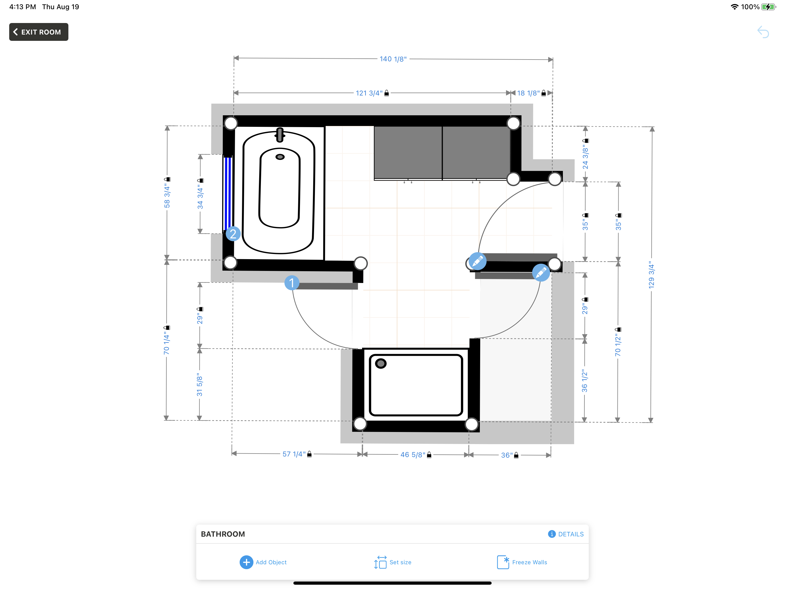

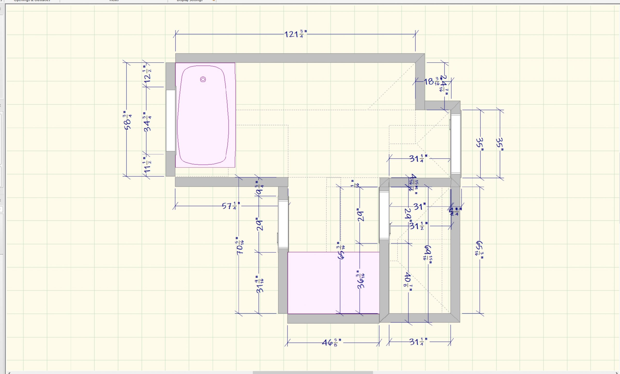

ParticipantHi Gang,
I’m using 13.0.0.79 I just imported a floorplan from the magicplan cloud. There were lots of wall errors. Mostly, walls that didnt join or meet at corners properly. It’s still usable, but needed a lot more correcting than usual.Did something change with v13 that would have affected this? I’ll report back when I have more new projects.
August 24, 2021 at 11:40 am #343654
ParticipantHi Chris,
We hadn’t made any changes to magic plan in v13 but we will test this to see if it is an issue. If it is, we will then mark it down as a bug for further investigation.
