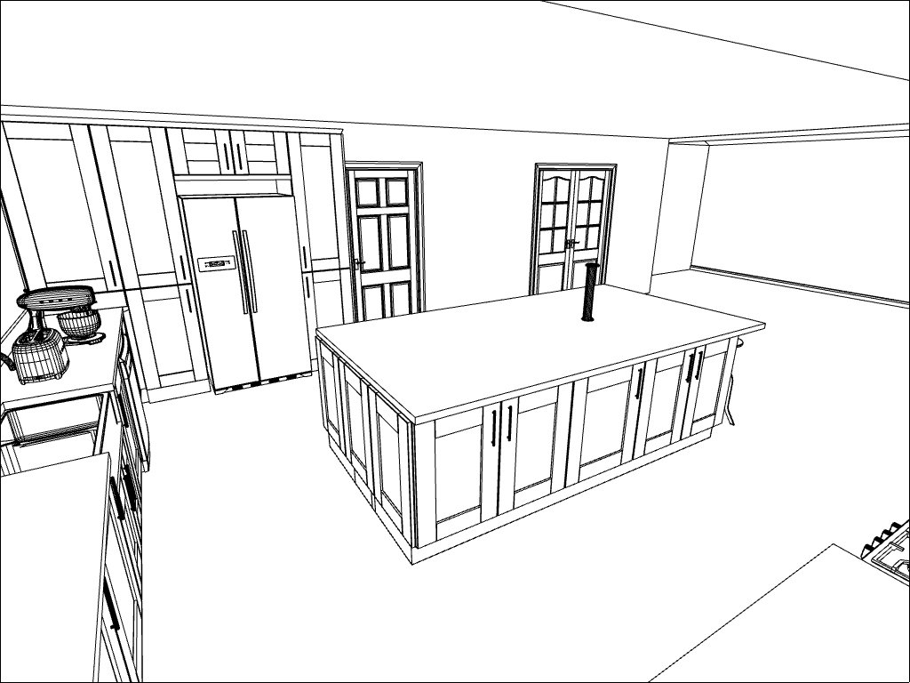

      Has anyone else noticed that when you add a door in pws second nature cat, it lets you drag it into the plan but doesnt show on the plan.

    • August 8, 2017 at 7:20 am #141527
      Richie
      hi i’ve attached 2 images plan showing no doors and the render showing doors
    • August 8, 2017 at 7:27 am #141544
      You mean those on island side ?
    • August 8, 2017 at 7:36 am #141545
      Richie
      yes I do

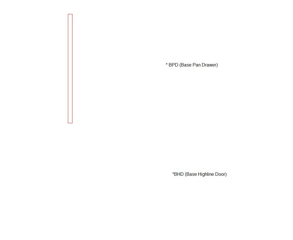

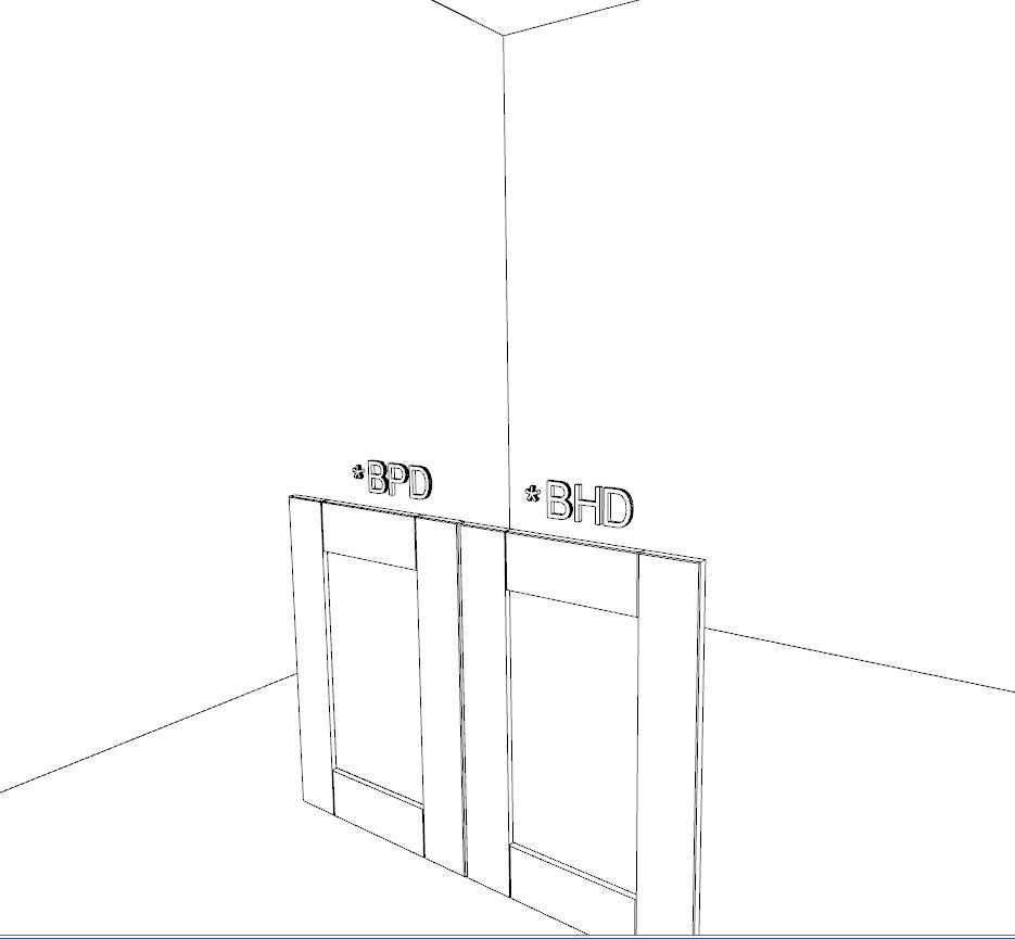

    • August 8, 2017 at 8:22 am #141546
      what I can do is to replace *BHD (Base Highline Door) with *BPD (Base Pan Drawer)
      take a look at attached files
    • August 8, 2017 at 8:28 am #141563
      Richie
      Yes I know I can substitue. the point i’m making is before a recent update the door was showing on the plan view.
