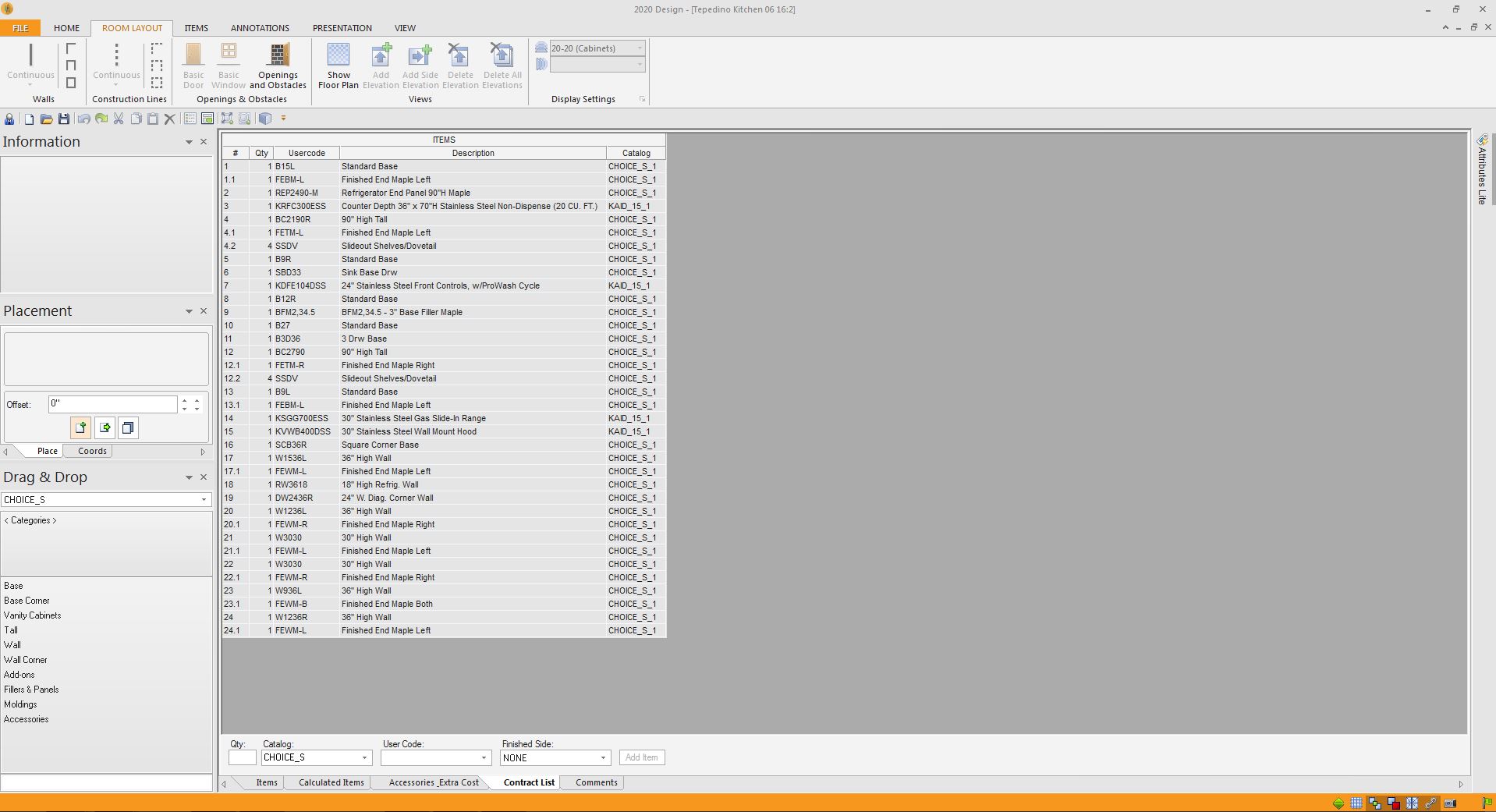

Pilot ProWhich report are you using? I’ve attached an example Quote from our system (ignore the pricing – we don’t use it) which shows accurate descriptions of each item.
An alternative which I know has been done is to export the items to a spreadsheet file and have someone write a customised excel script to import and format it the way you want.

Pilot ProThanks Mike! I tried the quote example you used, as well as the item list, either would be fine, but the descriptions are so non-descriptive. We’ve recently had customers change their mind or order the wrong size appliances after the contract was signed and we want to give them a list of the cabinets that they agreed to so there is no confusion down the line. I’m not sure if there is a way for me to change the descriptions or modify the report after the fact, but I hope so.

Re the generic descriptions – this is because your catalogue has been constructed that way. The part codes can be set to include the width as part of the code thereby showing cutome cabinets e.g. we allow clients to have an increase of up to 50mm before we charge for the next size up so althought the quote shows a 750mm 3 drawer unit, the part code might show a 780mm unit. That said, this is no good to you unless you can get your catalog author to change the catalog.
An alternative is to use the export option and then manually change the quote. Get the quote onscreen and rather than print it, click the export button. XLS exports to an Excel Spreadsheet but possibly you would rather choose the RTF option which can be opened and altered in Microsoft Word.
A decent spreadsheet programmer could write you a script to alter descriptions automatically in the spreadsheet format or you could maybe use search and replace in either spreadsheet or text formats.
