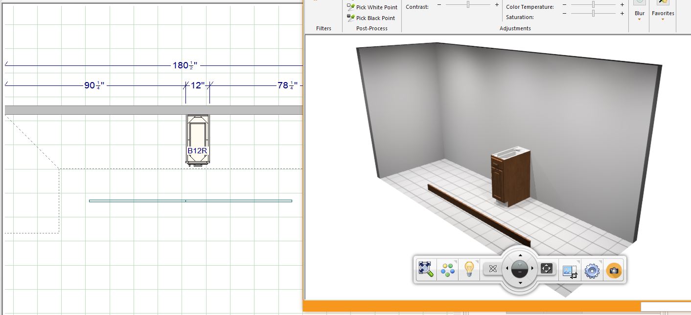

Normally toe kicks should still be present in the perspective view regardless if there is a placement zone or not. -See attached image below. As you can see, the toe kick still appears in the perspective even when outside of the placement zone.

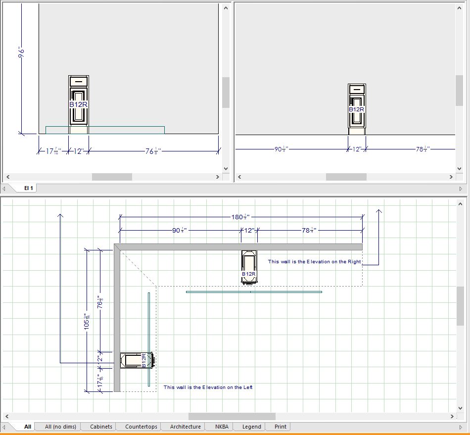

The only time the placement size will matter is when trying to view the elevation of a particular wall. The elevation will only show items that sit within its placement zone. -See attached image.
