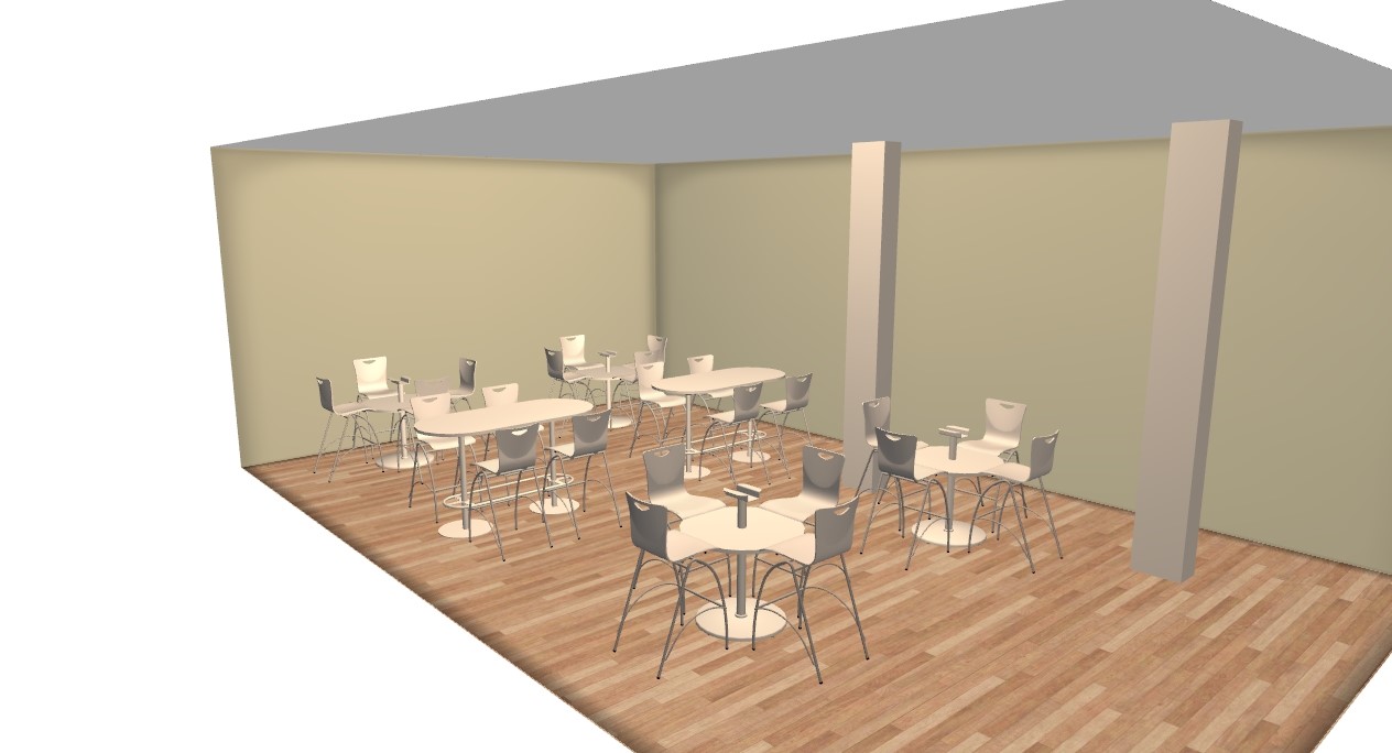

      When i transfer my AutoCad drawing to Visual Impression my table tops on my 42″h tables are at the seated 30″H height.  So my rendering ends up having the 42″H table base going through my table top.  Is there a way to move the table top to the 42″H within Visual Impression?

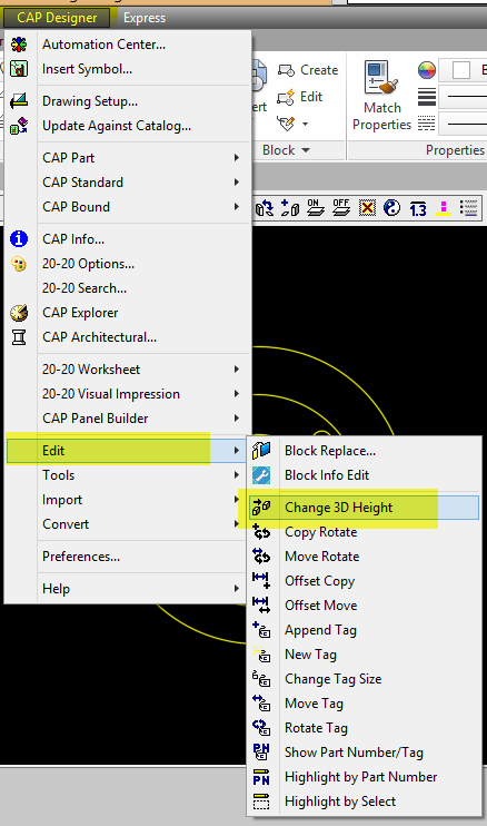

      Some items will require you to adjust the 3D height while in 2020 Cap.  If you use the Change 3D Height command to bring your table tops up, they should show correctly in 2020 Visual Impression.  If that does not solve the problem, I suggest emailing the exact product numbers to support to see if we can duplicate the issue.  commercial.support@2020spaces.com
