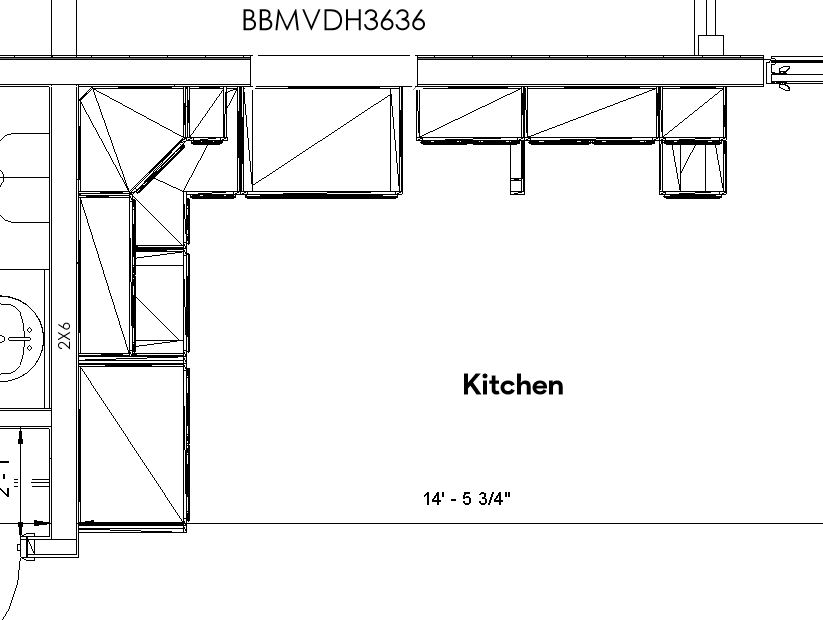

I am not really impressed with the export .dxf/.dwg function in 12 at all. I need to be able to export these to revit for what I do and now the .dxf export is in a quality where textures cannot be applied and plan drawings cannot even be used from the export. In 11 the export was almost exactly as the wireframe plan looked in plan and I could apply textures in revit to make it look realistic… what happened?
I use the kitchen I design as part of larger renderings and building plans of entire buildings that ive already drawn in revit and now I cant use what I design in 2020 for anything else.
Suggestions on how to mitigate this new problem?Attachments:

At this moment v12 provides the same level of functionalities as v11 however you should know that the team is having discussions to improve the AutoCAD export to also include labels and dimensions but no textures at this point.
Thanks for sharing your feedback, we will taking into consideration for future improvements.
Regards
Edith -

In V11 I could export to .dxf or .dwg and it looked in plan on revit or autocad like it did in 2020 design. I could also add texture to the import in revit to match how I had it shown in 2020 … now in v12 as you saw from the image theyre diagonal lines everywhere in exported cabinet plan and on the 3D view in revit when imported and somehow it is blocked from having texture added.
The export function definitely has changed for the worse in terms of exporting to .dwg or .dxf -
