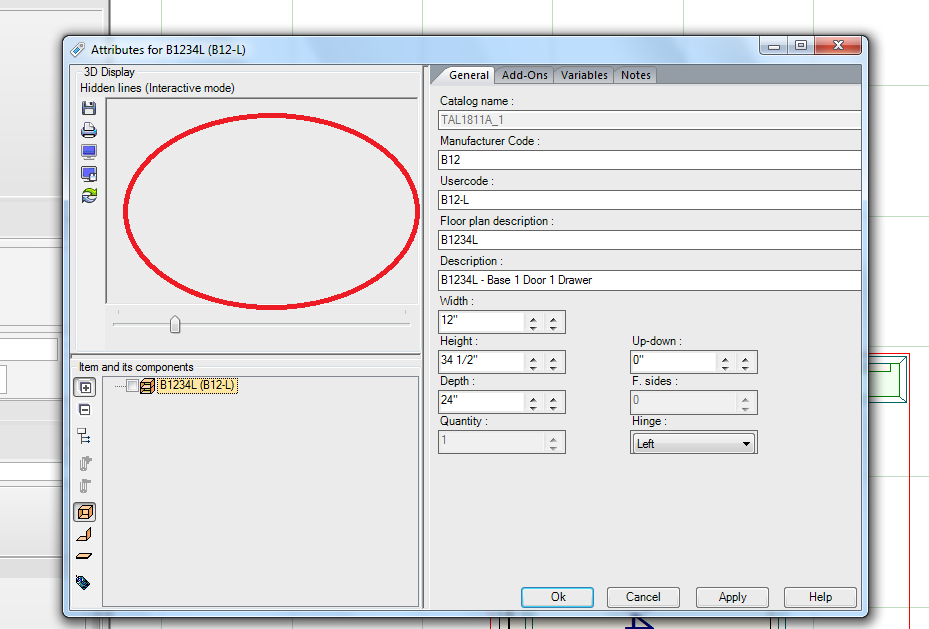

Hi!
Any ideas why I don’t get an image in the 3D display in the preview box (Top Right) in the attributes window?
December 12, 2018 at 11:14 am #220290Neil WilsonParticipant
Hi Corinthian,
That is usually an issue with either your video card or it’s driver. It is a common occurrence in computers that do not have dedicated video cards. The first thing to try is updating the drivers for your video card.
December 12, 2018 at 11:20 am #220291CorinthianParticipant
Thanks Neil. I’ll try to update the drivers.
December 12, 2018 at 11:44 am #220304CorinthianParticipant
Drivers are up to date. Any other suggestions?
Thanks.
December 12, 2018 at 11:45 am #220305Neil WilsonParticipant
What video card do you have?
December 12, 2018 at 12:11 pm #220306CorinthianParticipant
Intel(R) HD Graphics Family
Driver Version – 8.15.10.2291 -
December 12, 2018 at 12:15 pm #220307Neil WilsonParticipant
Hi Corinthian,
That’s the issue. It is not a dedicated card. The computer is below spec for the software.
December 12, 2018 at 12:47 pm #220309CorinthianParticipant
Bummer. OK. Thanks Neil.
December 12, 2018 at 6:06 pm #220325Mike LangensiepenPilot Pro
If it’s a notebook, there are various ways of getting an external graphics card to work
If it’s a desktop/tower, throw in an NVidia graphics card.
If you don’t like either of the above, buy a computer that matches or exceeds the minimum required specifications to run 2020 Design! 😎
December 13, 2018 at 9:07 am #220341CorinthianParticipant
Thanks Mike,
I think I’ll get my IT guy to install a graphics card.
