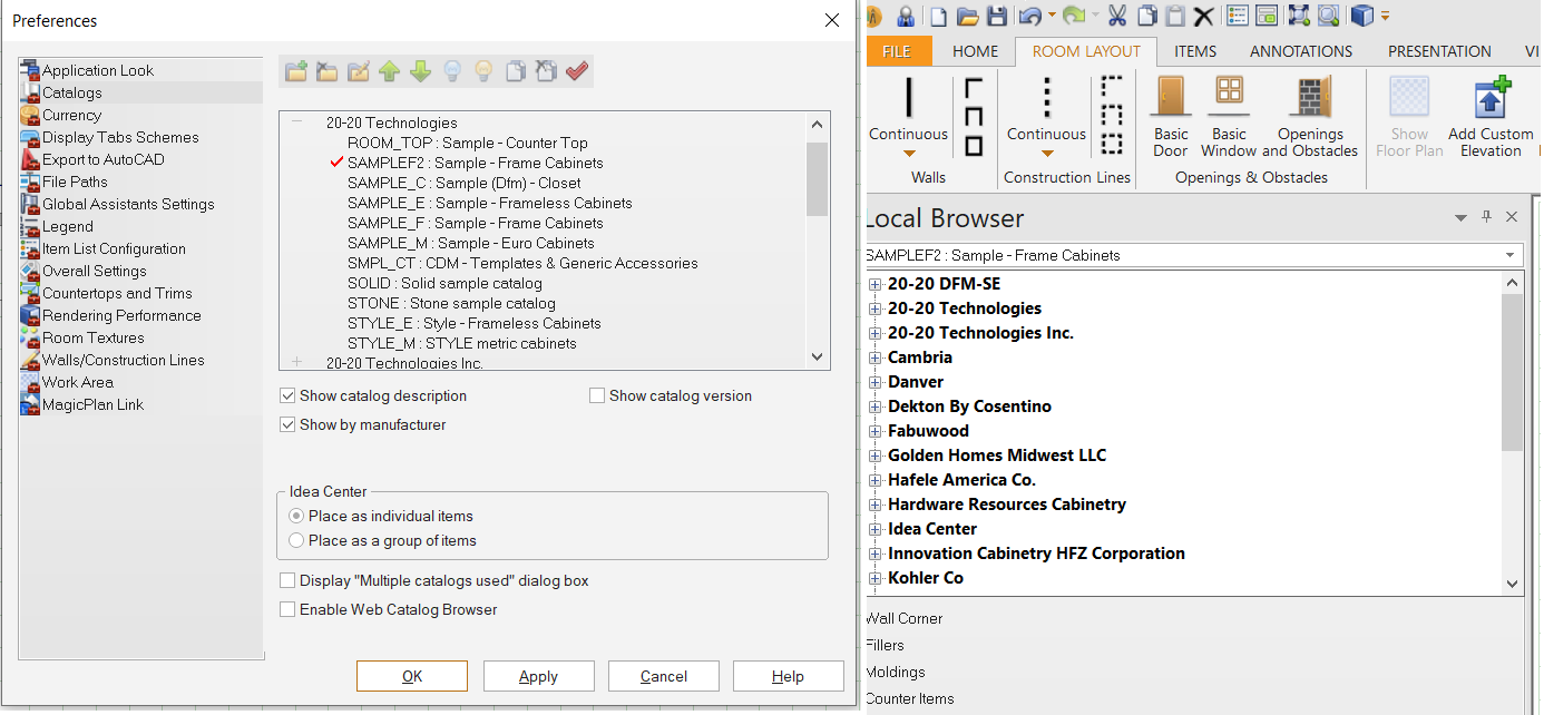

April 13, 2020 at 3:06 pm #277472Ron RussellParticipant
Another way to organize the catalogs, open up 2020/file/preferences/Catalogs/3 check box options to organize.
