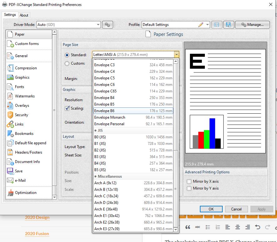

      The absolutely excellent PDF X-Change allows you to select Arch D but you have to buy it (well worth it as it allows you to edit PDFs and much more).
      Bullzip PDF – a free print to PDF program also has Arch D as well as many others.
