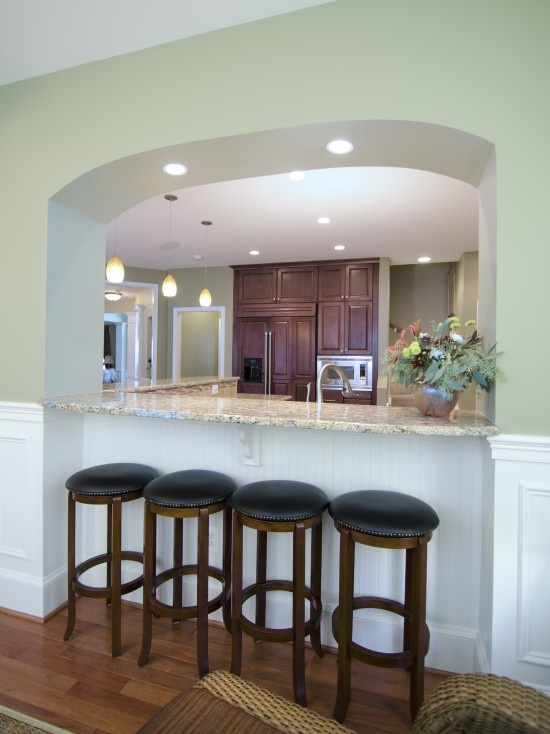

We are working on wall design and have an issue with 2020 Design 11.10.1.1
When making walls there is no option to modify a radius of a Wall Cut-Out / Pass through
Here is an example I found on Google of what we are looking to create. (also attached)
https://i.pinimg.com/736x/a7/62/b6/a762b609180c8cb09c1e6f0eaeedfb0c–kitchen-redo-kitchen-remodel.jpg
In pervious versions we could adjust the height or the radius but now we only get a few options and most are fixed to half circles etc.
Any advice?
Thank you in advance,
Zeljko

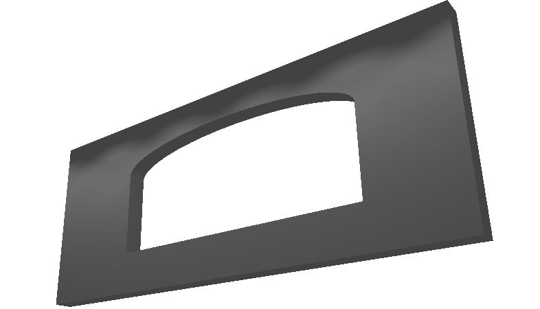

December 18, 2018 at 1:20 pm #221180Zeljko MarkovicParticipant
Hi Neil,
thanks for the reply. We are unable to edit/make that radius look larger on a longer opening. Do you have a setting to modify the radius? We do not see that.
It was possible before but I am reading there is an error or bug in the current software. We would suggest making that adjustment a feature again.
December 18, 2018 at 2:13 pm #221185Neil WilsonParticipant
Hi Zeljko,
You can’t type in the exact height unfortunately but you can edit the radius by dragging the center point on the pass through in the elevation view.
