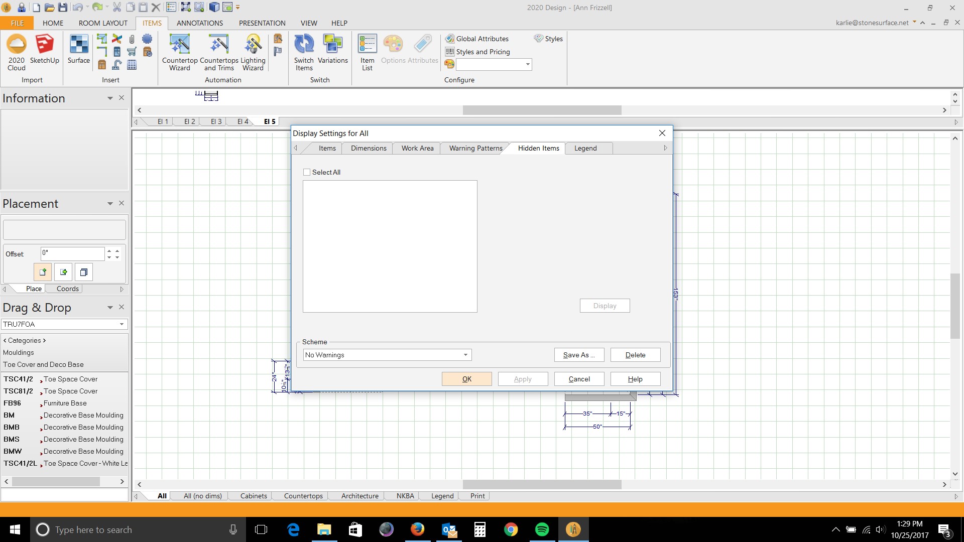

ParticipantI have this cabinet that shows up randomly only on my perspecitve views. I have attached a PDF view of it. I have no clue what this cabinet is or how it gets in my drawings. It doesnt show up on my floor plans, elevations, or item list, just my perspective. Any ideas why this is happening or what I can do to get rid of it?

It might be possible you have previously hidden an item from the floor plan.
Please check the “Hidden Items” tab of your floor plan “Display Settings”.

ParticipantHmm, nope. Nothing there. It’s not just this one particular drawing either, it shows up on different ones. And I always start a new file, so I’m not sure how it could be something that I’ve previously saved a certain way.
