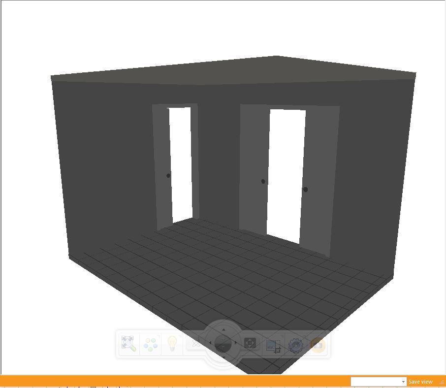

I’m in the midst of a design that uses a double pocket door and a single pocket door in the same corner. These being the entrances to two rooms, I’d like the customer to be able to see inside the room with those doors open. However- I do not seem to have the option to open pocket doors on the cloud supplied models.
Am I missing something? Does anyone have a shortcut or a fix for this?

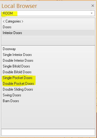

I was not able to find any Pocket Doors in the cloud, however I was able to find some in our ROOM catalog that can open and close.
To find the doors, they will be found in ROOM > Doors > Interior Doors… then you can choose “Single Pocket Doors” or “Double Pocket Doors” – See image below.

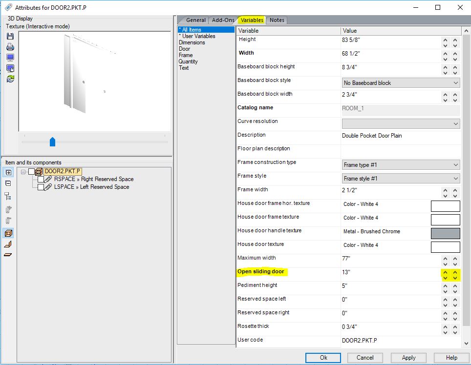

To open these doors, you can go to the Attributes page and then go to Variables.. from the Variables page, you want to “Open Sliding Door” – See image below.
Hope this helps!
