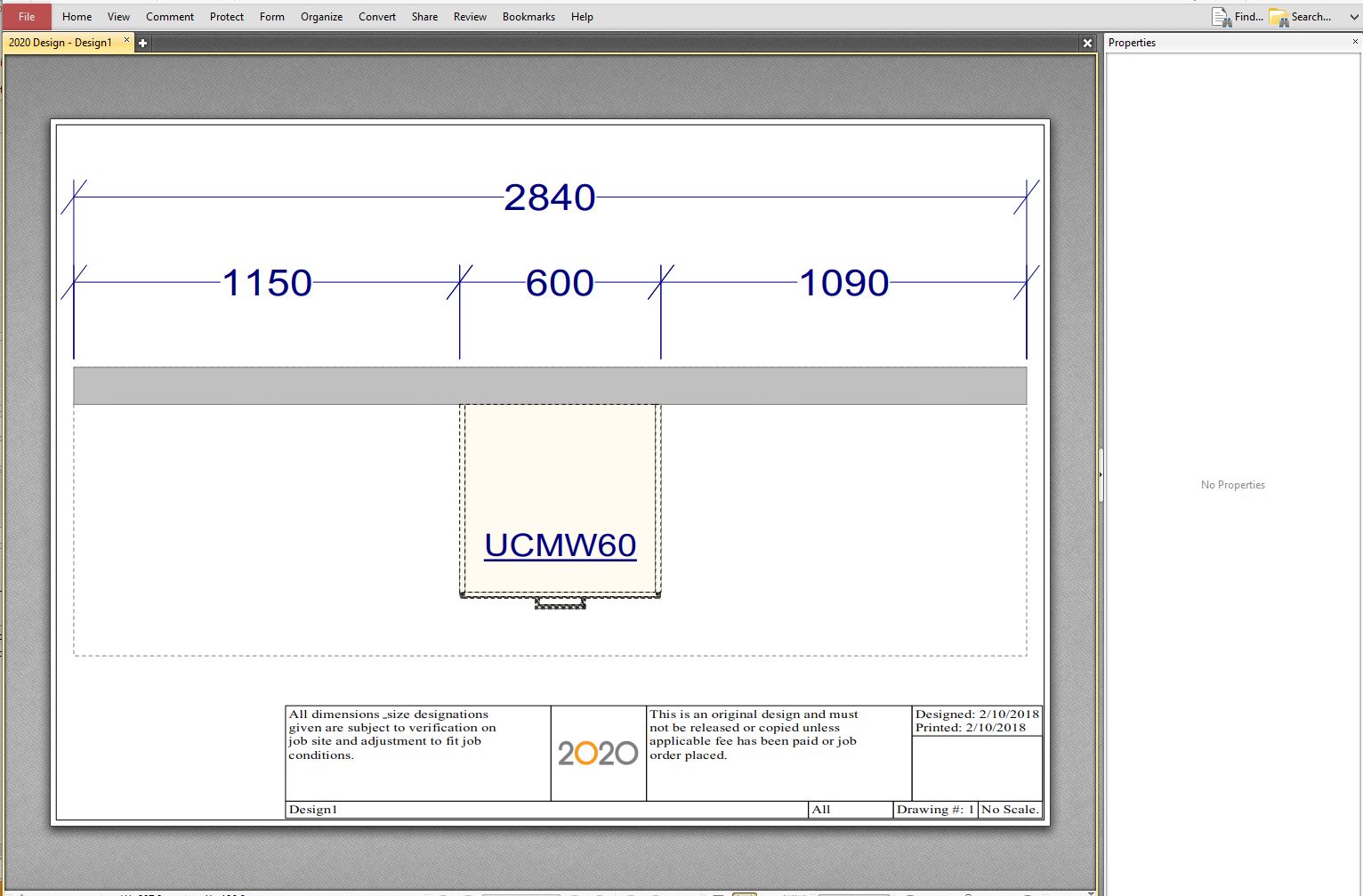

Works fine for me – I always choose Print/Selection/All (or whatever Tabs I want). See attached.
I think you may be modifying the display settings on one tab and printing a different one.
