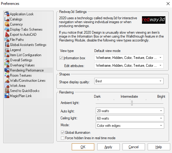

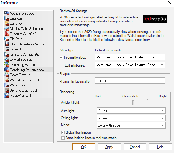

September 8, 2016 at 4:03 pm #100445Patrick CentoreParticipant
<div>Hello,
I believe we are experiencing a similar issue to what you experienced, however our video driver is up to date and compatible and we are still having no success rendering.Basic Computer Specs
2020 Version: 11.5.1.4
GPU – geforce gtx 745
GPU Driver Version – 372.70
CPU – intel(R) Core(TM) i7-6700 CPU @ 3.40GHz
Memory – 16.00 GB RAM (15.94 GB Usable)
Current Resolution – 1280 x 720, 60Hz
Operating System – Microsoft Windows 10 Home (64 bit)Our Issue:
Each time we go to render there are two results that occur.#1 – With the shapes on the “best” quality setting, 2020 stops working and crashes saying it has to close and saying Windows will notify us if there is a solution, but nothing happens.
#2 – With the only difference being the shapes on the “normal” quality setting, 2020 will load the render module, but only stays as a blank white screen.
Is this indeed similar to what you were experiencing? Or does anyone have suggestions to help? It is a brand new PC as we have just updated our equipment so all drivers and updates should be present. I have attempted this in the hidden line, color with line, color with texture and all still yield the same results. I have made sure the “obstacles and openings” wizard is closed and not trying to create another scene. It may be worth noting that the 2020 cloud never seems to connect on this computer either.
Our other computer is running the same version and has no issues at all with rendering. This computer with the issue should be the better of the two we have, but if there is something we should be checking other than what I’ve covered please do let us know.
I’ve attached images of the settings we were attempting. Any help would be appreciated. Thank you in advance.</div>
</div>Attachments:
September 8, 2016 at 5:18 pm #100478Patrick CentoreParticipant
Update:
I was not fully informed we had a live chat support functionality with our services, after speaking with the agent and allowing them to verify the patch update was installed it was found that our problem was a simple glitch that can happen from time to time with the program. To solve it, simply copy and paste the design into a new document. From there our renderings worked perfectly fine. We saved it as a version 2 and tested opening it again and it works to render again. A simple trick that may save some people a headache. NOTE: if you copy and paste the design to the new document you will have to redo all your styles as they do not carry over.
