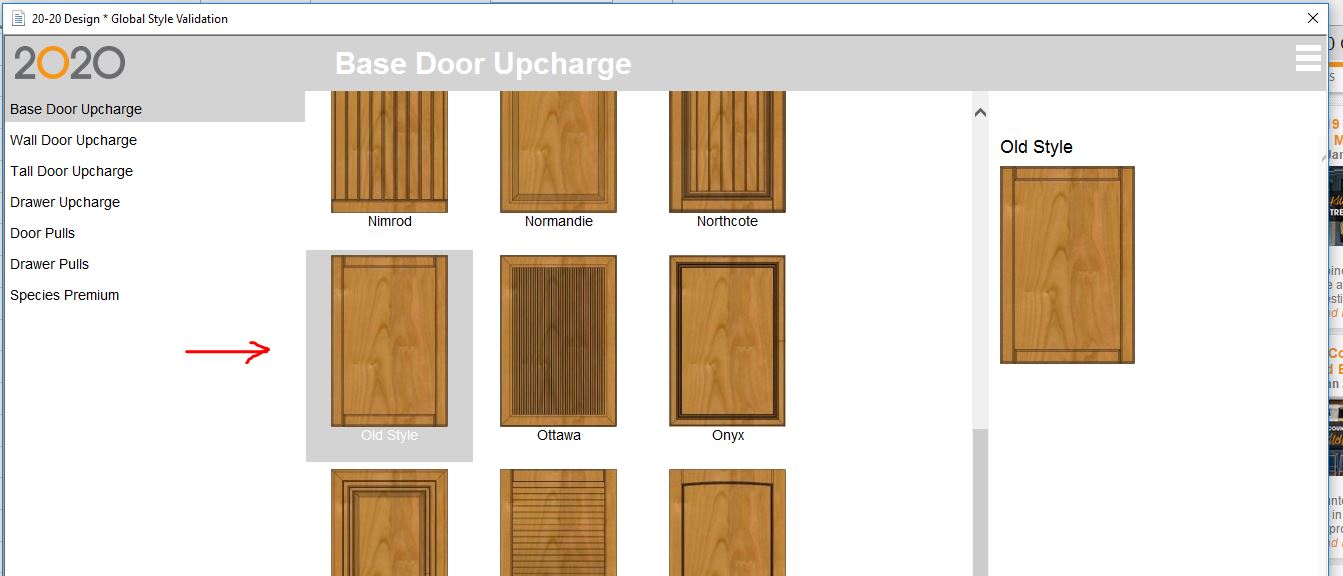

January 30, 2019 at 10:16 am #225574Info ATLCabinetryParticipant
Question: How do you change the door styles to look like a true Shaker Grey, Espresso or White. I have basic sample catalogs, also we downloaded some free manufacturer catalogs so we can show actuate renderings of our door styles. However, I am told our 2020 License key does not allow us to install the free catalogs.
I am so confused, I have used 2020 since ver 6. This is new to me hearing I can not install free catalogs. Please advise
Thank you , Ginger

January 31, 2019 at 12:46 pm #225723Neil WilsonParticipant
Hi,
From what I’ve been told an essentials license holder should be entitled to any of the Appliance or Accessory catalogs on 2020.net but the cabinetry catalogs are not all encrypted for use by essentials users. This is a decision made by the manufacturer.
For the shaker door style in the sample catalogs one of out trainers told me to recommend the Old Style door style from the Sample catalogs. The colour will be set in species premium.
Hope that helps.

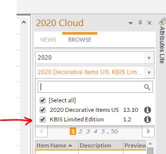

March 1, 2019 at 1:38 pm #228306John Paul RamosParticipant
Dear All,
There is a KBIS Limited Edition catalog and it is available in a limited time. It says it is available in 2020 Cloud under “KBIS Limited Edition”. My question is, when you are in 2020, you are linked to 2020 cloud then choose “Browse”, right below the categories, I typed in “KBIS Limited Edition” but there is no items available. I think I missed something or am I in the wrong path. Where can I find this catalogs? If anyone tried this, I need your help.
Many Thanks,
John Paul
March 1, 2019 at 4:02 pm #228318Neil WilsonParticipant
Hi John Paul,
The KBIS content is in the 2020 section under decorative items in the catalog section of the Cloud browser selections.
March 1, 2019 at 11:47 pm #228336John Paul RamosParticipant
I got it.. Thanks much Neil..
