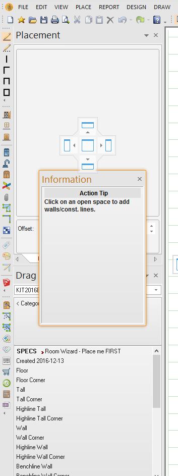

I went from version 9 to 11 this past week and I have pretty much found were everything is and learning new tricks, however my drag and drop, information, and placement boxes have become ungrouped on the left side and are now individuals and they don’t group back together as in version 9 can someone explain how to get this back?

It is very easy in V11 for the Info and Placement boxes to become ‘undocked’. You should be able to grab them and start moving them into place until you see some blue ‘placement’ options appear (see attachment) – move the box onto one of the placement options (try the top or bottom one) and your box will re-dock in that position – it takes a couple of goes and a bit of playing but it should happen.

I’ve recorded 2 videos that might be of help. The first is an example of the above and the second is an example of using the Registry Settings Saver that I posted about a week ago.
