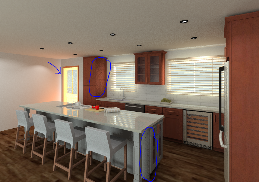

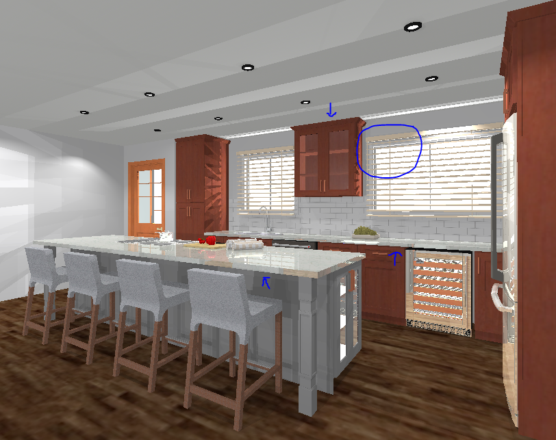

I’m having issues with the quality of my renderings. I just got a new computer that is more than capable of running the program – and others at the same time. In fact the rendering quality was one of the reasons I upgraded!
Here are the problems I’m having:
In quick rendering mode, I’m getting lots of jagged edges. Even set to high quality.
In high resolution rendering mode, I’m getting quite a bit of pixilation and the door is rendering as if it’s on fire – completely over exposed. Even if I turn the Sun visibility to off.Attachments:

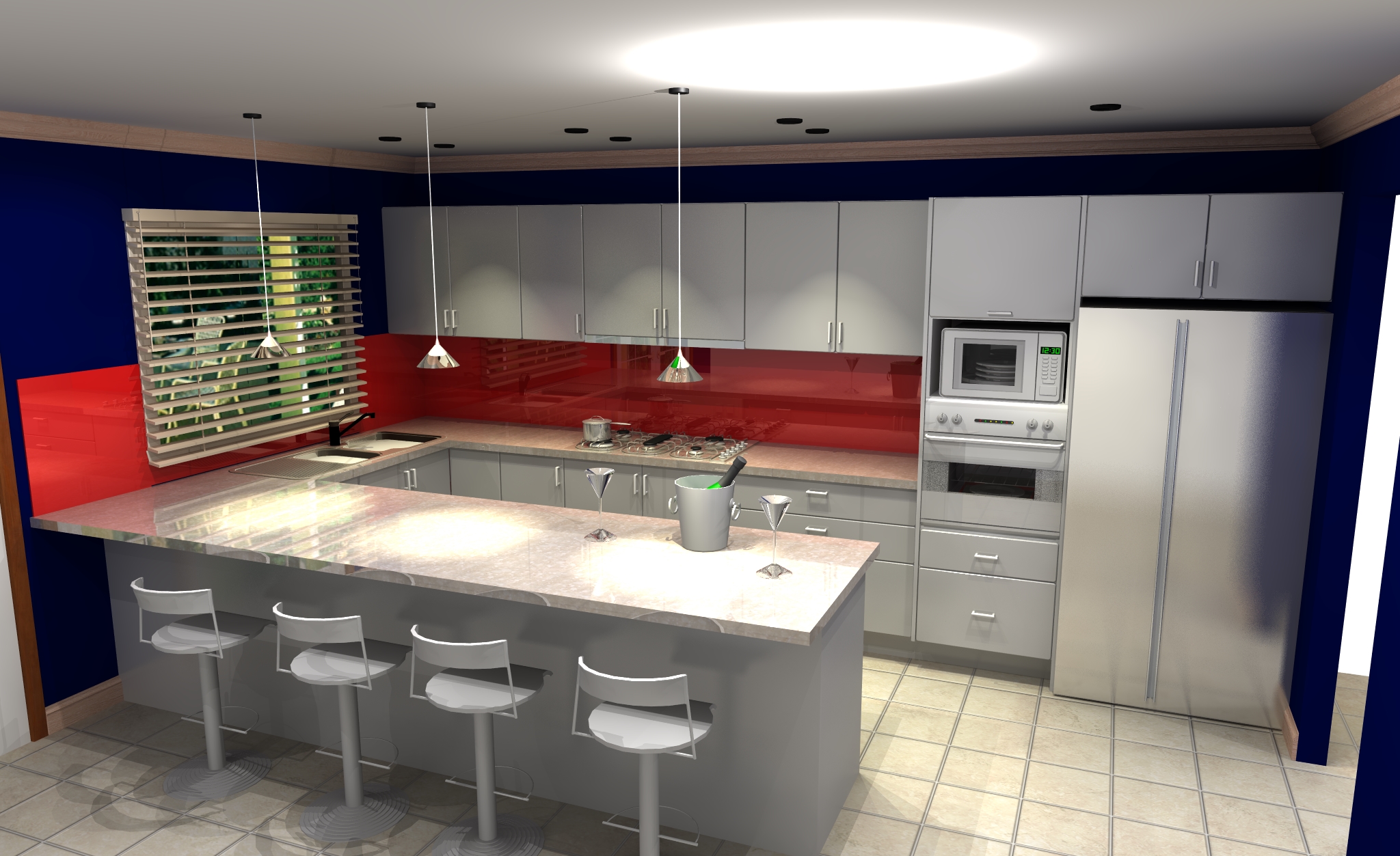

Just so you have some comparative timings I did a test. On my modest i7-2.4GHz Toshiba notebooik with 2GB AMD Radeon I get the following:
Onscreen standard render takes 7 seconds
Clicking the photo realistic option takes 5 minutes
Saving as high res image 2K resolution takes 7 minutes
Saving as high res image 4K resolution takes 40 minutes
I then printed both images out sized to fit an A4 sheet of paper on our big flashy Sharp Copier/Printer and could see little to no difference between the 2K and 4K images.
When I render onscreen I don’t render fullscreen as it is unneccesary most of the time. A smaller render window means a faster render time. As you can see from the above times, doubling the (save as) image size results in the render time increasing by 600% so unless you need the very high res images then there is no point in creating them.
Hope this helps. It might be an idea for you to post the specification of your PC – I use the free SPECCY tool for this.

Mike, The attachment.. is that the his res 4k rendering? It looks pretty sharp!

The image was the 2K fast one – this forum doesn’t allow larger attachments. The 4K (3K in size, 4K in resolution) one is here:
https://www.dropbox.com/s/yn14nyvsops7hmn/Example.jpg?dl=0
Honestly though, I don’t see why you would bother with a 4K render under most circumstances. The average inkjet or laser will do a good jub of blurring (think primitive antialiasing) the edges of lines for you.
