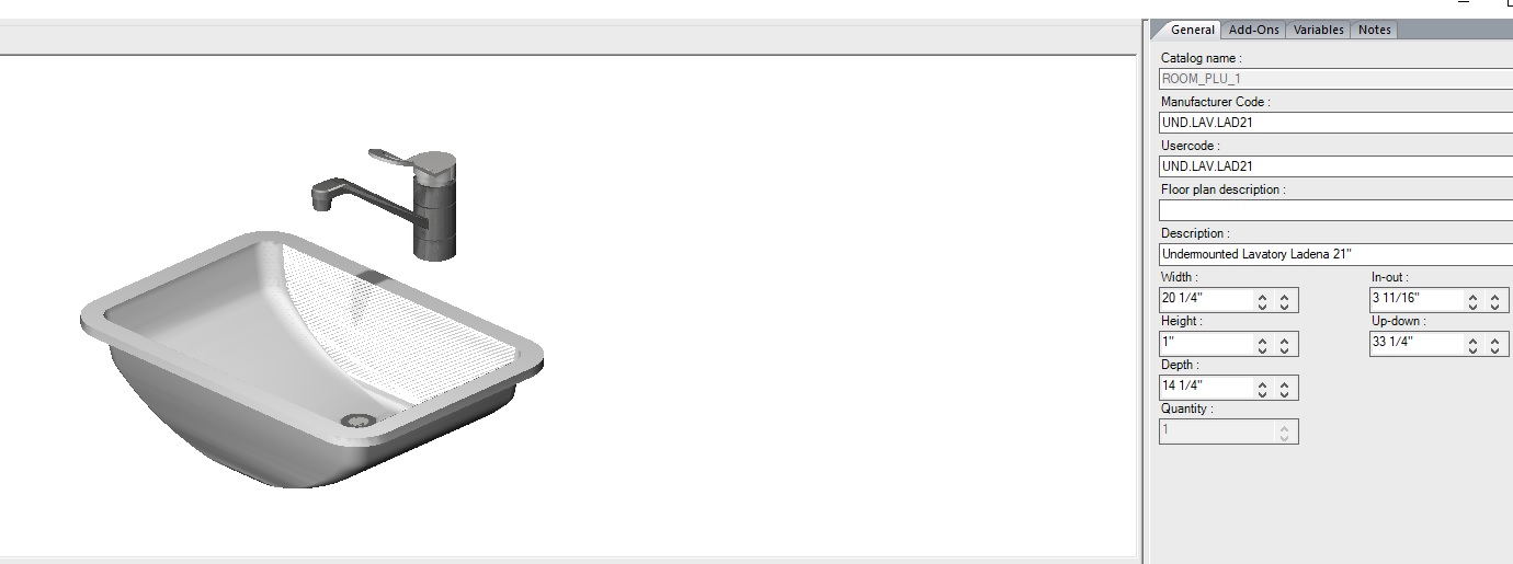

Ariana ThompsonParticipantFound this in the Plumbing catalogue – but you only see it when you go into the Plumbing Catalogue.
I always like to choose my plumbing using the Catalogue Browser, as you get little thumbnails.
And….am I crazy, or are there MORE things to choose from when you go in that way than when you just click the plumbing icon?

Mike LangensiepenPilot ProHi Ariana, Nice find but unfortunately, can’t resize it.

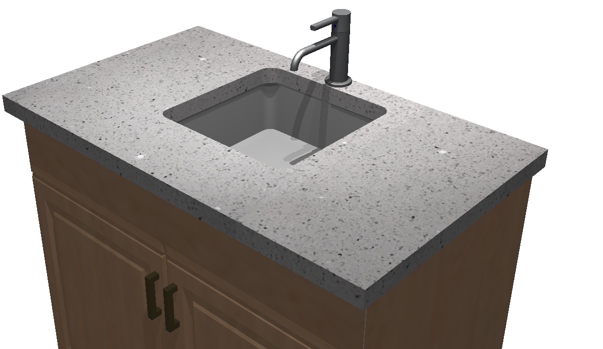

Ariana ThompsonParticipantOkay – a MILLION years after the fact – but for anyone who finds this thread because they searched the topic, I just came across this during a design and remembered this thread:
ROOM-Plumbing catalogue
Sink and Lav Add-Ons/Lav/Vessels/
I chose the VESSEL.RECT.BCK48.
This is an attachment – so it won’t let you drop it just anywhere – it has to be dropped onto a cabinet. To adjust the size, you need to go into Attributes under the VARIABLES tab.
Use “Attachment Width”, “Attachment Height”, and “Attachment Depth” to alter the dims – changing the normal dims will do nothing. You can grab it in Elevation and lower it to be an undermount, or use “Attachment Origin Y” to adjust the Up/Down.
You may have to manually mod the ctop around it – but you have to do that with half the sinks in the Cloud anyway.
