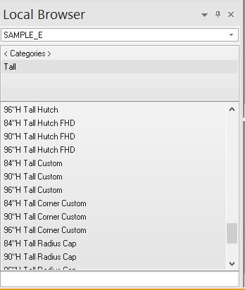

Unfortunately that is correct, the cloud items will not make the cut out in the item you use. What you would be able to do however is go into the Sample_E or F catalog and then use a Tall Custom cabinet to manually create the cut-out in the item.
After that you can drag the appliance from the cloud into the tall unit and then use an Elevation to place the item properly into the opening.

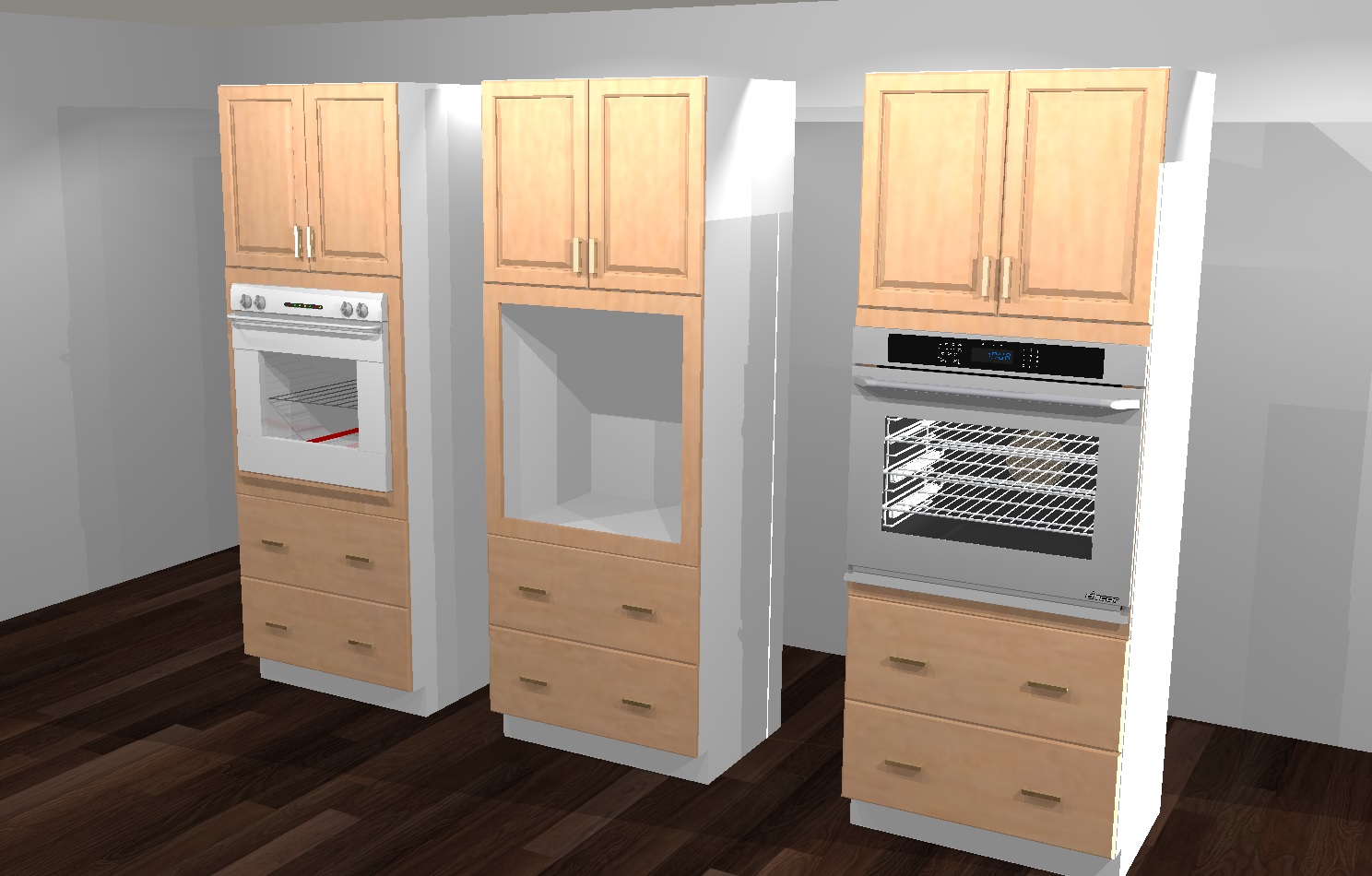

I have attached an example of how I do it.
On the Left is the cabinet with the generic oven already in it.
In the middle, is the cabinet after I have gone into it’s Attributes and switched “Oven” to style number 0 (which makes the oven disappear).
On the Right is a Cloud Oven added. Weird thing – at least in the Manufacturer’s catalogue I use – if the oven LOOKS centred on the floor plan, it will invariably be misaligned in the render.
I have to right click on the oven *in the rendering* and Drag or In/Out it until it looks right.
Hope that’s helpful!
