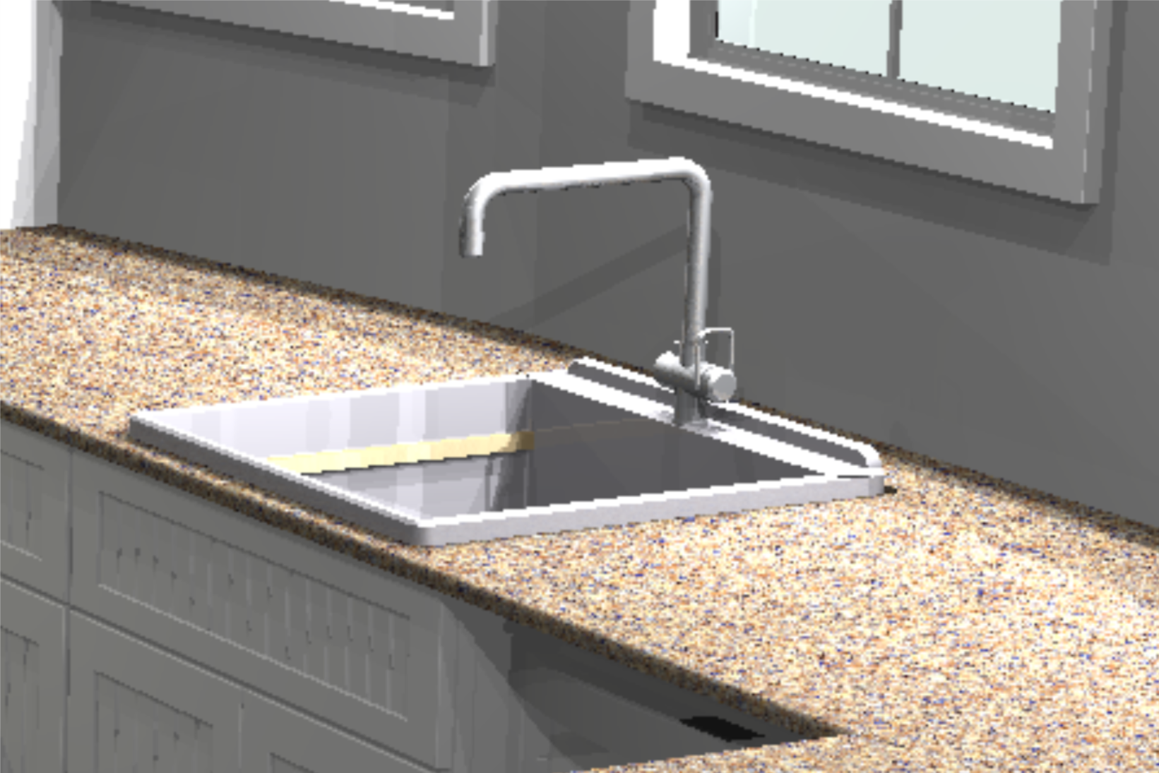

Just trying to figure out how the cut back or shorten the wood under the sink base. I go and place say a farm sink into the sink base and the wood inserts stick through the sink in the rendering. I just can’t seem to find the options for those pieces. If anyone could help that would be great

May 4, 2018 at 10:14 pm #185360Bryce RobertsParticipant
I work with Fieldstone cabinetry and Every time I put a sink in these sink/range base the wood in the cabinet sticks through the sink.
attached is a picture
May 8, 2018 at 12:24 pm #185465Neil WilsonParticipant
Thanks for the view Bryce.
Would it be possible to send an email to residentialsupport@2020spaces.com with the name of the catalog (as it shows in the drag and drop), the name of the sink(s) and the name of the cabinet(s) so we can investigate further?
August 30, 2018 at 3:15 pm #201947Ariana ThompsonParticipant
I know this is an older post – but here’s what I do:
I go into the Attributes of the sinkbase, go to Variables and choose Textures.
Change the colour of the Rails to None/Transparent.
