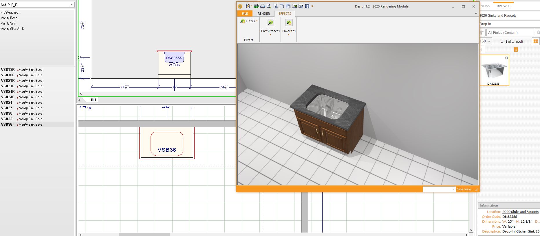

ParticipantHi Cheryl,
Make sure that the sink is being placed at the correct height. An easy way to do so is to open an elevation of the wall with the sink base to see where the sink is placed on top of it. Click HERE to check out the article on how to add an elevation. I had added an image below as an example.
