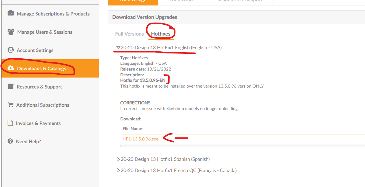

January 25, 2023 at 11:18 am #419188Kristopher PapaleoParticipant
Hi Drag,
You can find the hotfix for version 13.5 by signing into your 2020 cloud account and going to Downloads & Catalogs and then go to Hotfixes. You can sign into you cloud account by clicking HERE.
