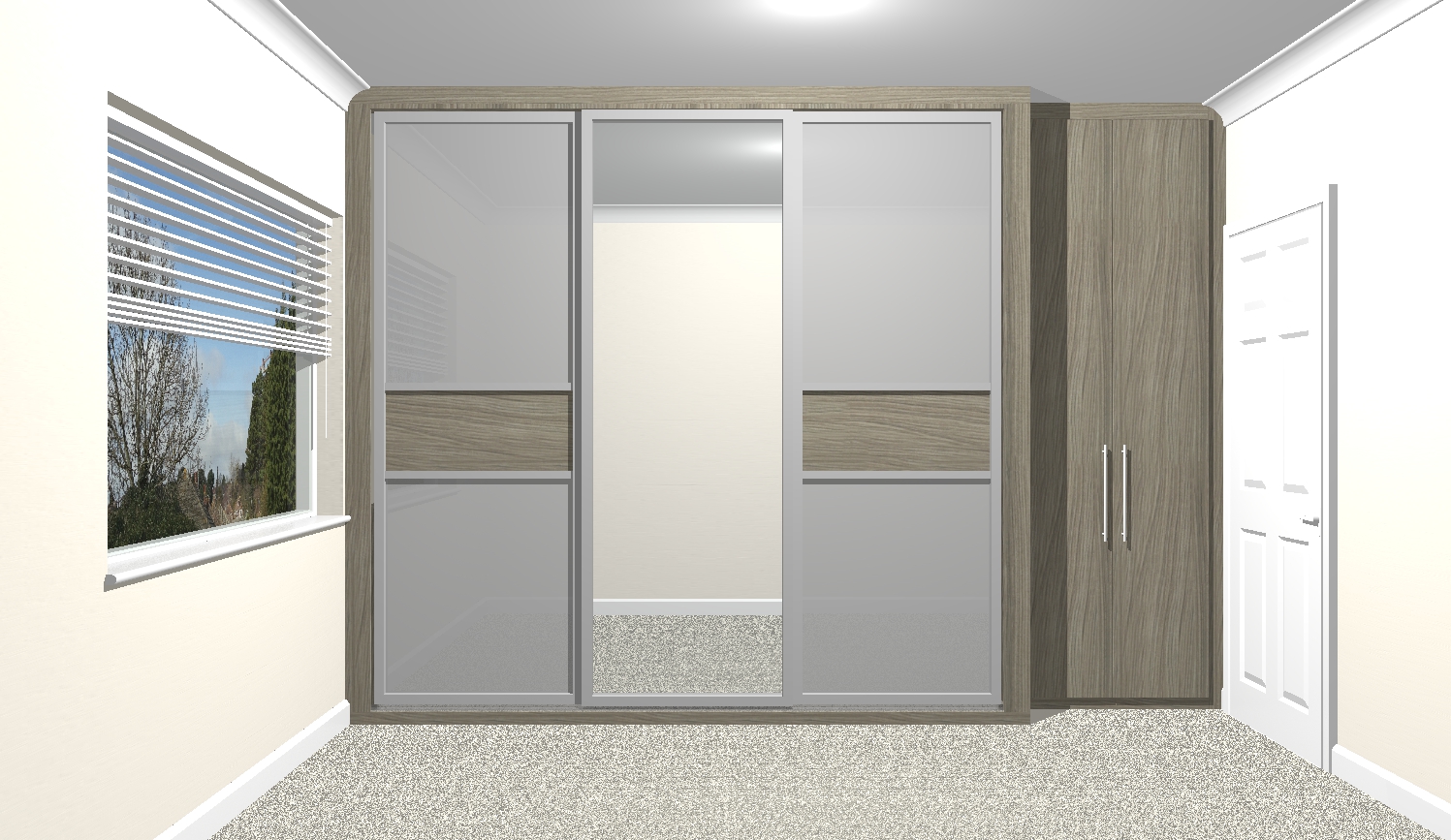

      I design a lot of bedrooms with doors that have varying height panels and different materials, currently I can only find options for 2 or 3 doors split into thirds. Quite often I also need to have the middle of three doors as a mirror door which I can’t do on Fusion.
      I use to use a different CAD system which gave me complete control over panel heights, colours and number of doors.

      I’ve attached a typical design from my old software to show what I need to be able to achieve.
      I’m just using Universal Bedrooms, Crown Bedrooms and Duvall at the moment there doesn’t seem to be many others.
      I have to keep going back to my old CAD software at the moment which is not ideal as my new company use Fusion 2020.
