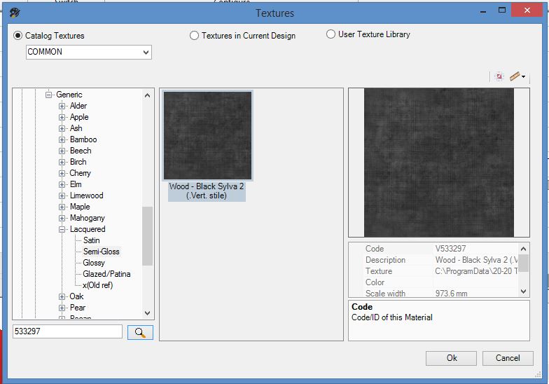

What does work (for me anyway) is to Ctrl Click each splashback to select multiple surfaces then right click and go to Attributes/Textures and just change it once.
Also, instead of drilling down and if your are using textures from ‘Common’, you can always just look up the code number for that texture and then type that in and hit the search icon and it will take you straight to it.
