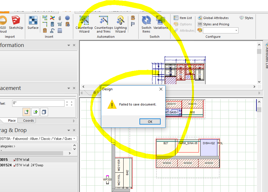

ParticipantIs there anyone having the same problems like attached picture?
I added just the same texture as the cabinet fronts to the side panels and now I cant save the projects that means Im working on a dead file. I cant copy it to another file.
Could you help me on this?
Is there any way to reduce the texture cost on RAM? My computer has 8GB and

Out of memory messages are an ongoing issue with 2020 that they are working hard to resolve. The issue arises from the fact that 2020 Design is still a 32bit application. As a result of that Windows will only ever assign about 2.5 GB of RAM to the program. If 2020 has been open for a long period (3-4 hours), If there are multiple designs or multiple renderings open, if you modify mouldings or countertops, if you import Items from Sketchup or use imported textures, etc… the memory allotment fills up and you will start to get these errors.
To avoid the error the first thing to do is make sure you are on the latest version of the software. They made some changes in version 11.8 and higher that have a positive effect on memory management. Make sure you have the latest driver for your video card. Newer drivers are generally more efficient than older drivers. Other things you can try is to limit the size of your designs. If you usually layout the entire ground floor of the house, try to limit it to just the kitchen or bathroom you are designing instead. Limit the number of items imported from Sketchup. 2020 has no control over the quality of the items generated in Sketchup and as such some of them will cause issues with the software. The same with importing textures. Imported textures are much “Heavier” that textured pulled from the catalogs and can cause the out of memory issues.
If you do get the memory error or the failed to save error one thing you can do to save the design is to select everything in the design. Use the mouse, hold down the left mouse button and lasso the entire design. Once everything is selected go to the home tab and select copy. After you select copy, close design without saving the file. Reopen 2020 and then go to the home tab and select paste. Left click on the floorplan to drop the design back in. This works because when you do a copy the design goes to the Windows Clipboard that is in a different memory space than the 2020 program. Closing and reopening the software clears the memory cache and so you copy the design back in to a clean space.
