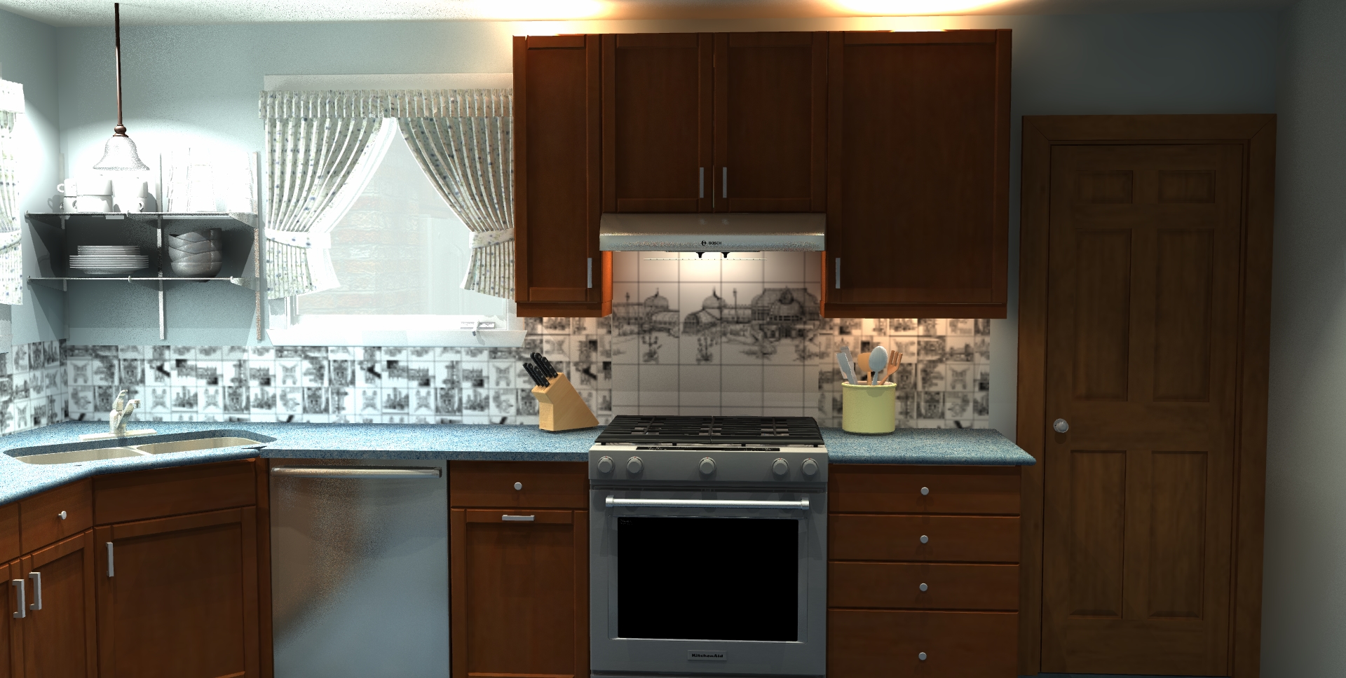

Chris SetlockParticipantA local artist is making a custom mosaic to use as a focal point. To help the client visualize the final piece, I made a 30×30 jpg of the proposed mosaic, which I used as a custom texture for a surface field. In the attributes thumbnail, it looks perfect. When I then generate a rendering, the origin point of the texture shifts to the horizontal center of the field, so the image is bisected and reassembled.
The texture, and the surface field are both 30×30″, so it should work perfectly.

Sorry for the long delay in the response. Had to do some testing. From the attached image you will see that I get the same thing if I use a surface or a 3d shape but if you use a picture (that one is from the cloud) and change the texture of the image it works great.
It seems that the point of origin used in the surface and on the 3d shapes does not correspond to the corner of the item so the image tiles.
