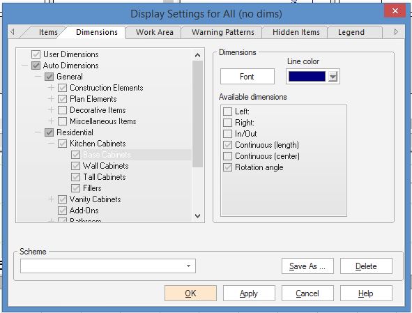

Mike LangensiepenPilot ProHi Alan,
It’s all a matter of learning how to set and use the Display Schemes but there will always be situations where even with a totally optimised Display Scheme that you have unwanted dimensions. In this case, I tend to turn those dimensions off and dimension manually. The problem with hiding automatic dimensions is that they usually end up coming back again.
Manually added Dimensions fall under the ‘User’ heading in the Display Schemes and should be switched on for all Display Schemes (they are often off) – I find them especially helpful when using the All (No Dimms) Scheme as this gives me a very uncluttered view and I can just show dimensions that are especially critical.
