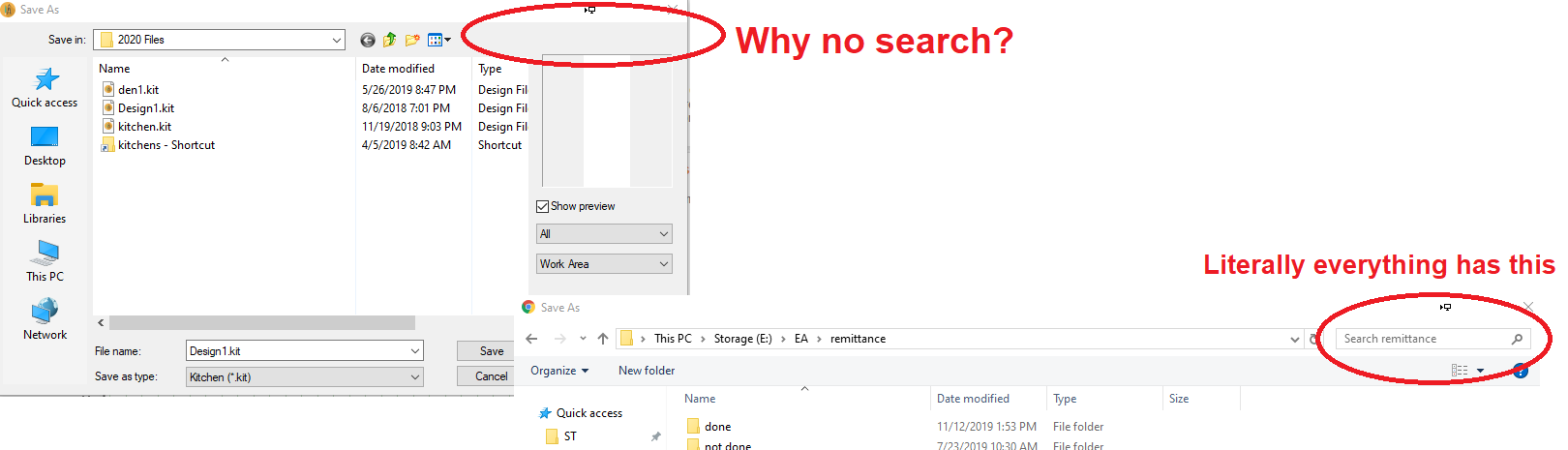

dennis audet
ParticipantWill the new version allow searching in the folder view like almost every other program does? As our company gets more and more customers when we go to save a new screen shot of a KIT we have to scroll down a huge list of folders since theres no search box. Ive noticed on new drawings it will default the save path for screen shots into the folder i saved the KIT to but if im updating a KIT at a later date and go to save a new screen shot it doesnt default to that KITs folder

November 13, 2019 at 3:12 pm #259528
ParticipantHi Dennis,
There has actually always been a way to search for files and folders. To search for a file/folder, go to File > Open. Where it says “File Name” you can type the name you are looking for and then select the file and click on “Open”. Another way to go about it is when the Open file window is open, single click on any design and then start typing the name you are looking for. That will bring you directly to that file.

November 13, 2019 at 10:21 pm #259732
dennis audet
ParticipantThanks for trying to answer my question but you are incorrect. What you suggest might help me find a kit file if all kit files are sloppily placed in one singular folder. I just tested this out on my own it doesnt even limit the folders i can see if i type in a customer name. I honestly cant imagine anyone who uses 2020 having all kits store in one folder rather than using sub folders for each customer. Perhaps its just a different of how people use the program. but for us we make sub folders for all of our customers which has the pictures of the room, hand drawn measures to convert to 2020 drawings, quotes etc. We have nearly 1000 sub folders in our kitchen folder, the whole folder has nearly 15,000 files that would be a lot of kits, photos, quotes all jumbled into 1 huge sloppy folder if thats how you do things.
I was simply asking why this program which is windows only is lacking a simple common sense basic windows function that every single application on the face of the planet has.
