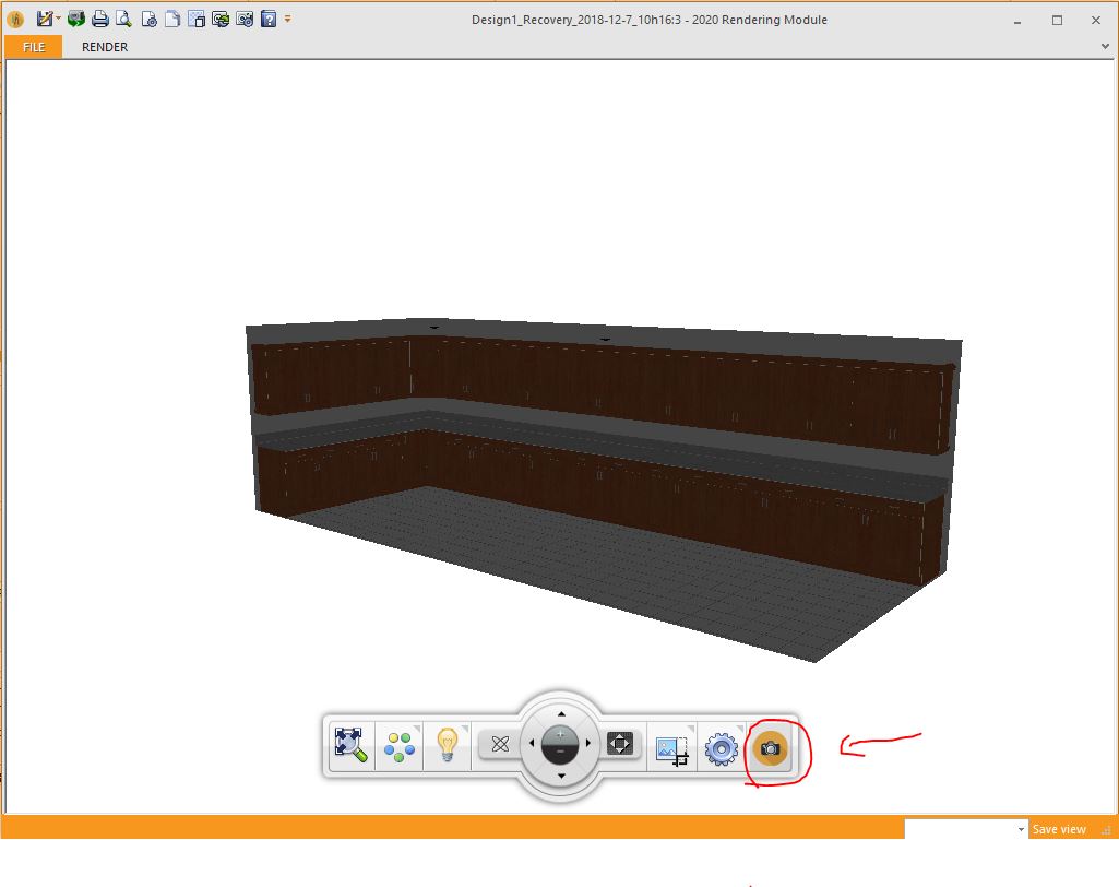

    • December 5, 2019 at 3:41 pm #261666
      Hi Cameron,
      Texture is the best for quality. Once you create your rendering and get the look you want, you can then click on “Launch High-Quality Rendering to get an even higher quality image.
      See image.
