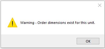

      I really hate this text box. It is relentless. How can I get it to stop. I’m not bothered about using the correct codes for items, it’s faster to resize and move, rather than type in the correct code and replace (we don’t use the in-built quoting system). How can I stop this box from popping up?
      Cheers

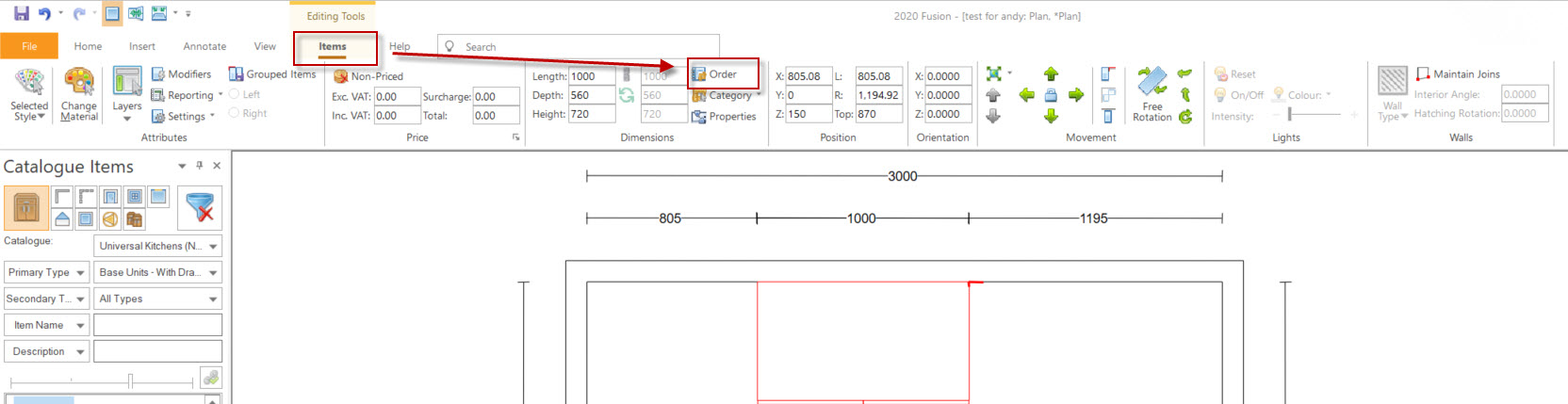

      Hi Ashley,
      Can you confirm if you have the “Order” button enabled? See attached screenshot.
      This button should be disabled, so not highlighted.
      if you prefer we can always have a remote support session? please send a email to fusionsupport@2020spaces.com
