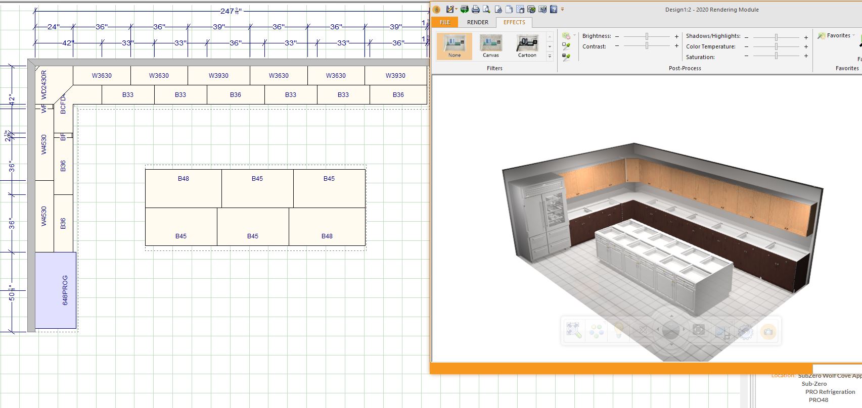

        First – I rather like the 2020 V12 edition. However, I have found myself spending a massive amount of unnecessary time accomplishing relatively simple tasks that I’ve been able to do fairly easily in other more rudimentary kitchen design software programs. Some of the limitations are a bit astounding and very frustrating.
        1. Moldings on walls which are different heights on two ends. For example, cannot show crown molding on a wall which is 120″ on left side, and 96″ on the other side. Crown and other moldings will only appear in a straight line at one up/down value above the floor.
        2. Ability to edit trim, general shapes and lines in the elevation view. Can currently create a running line in an elevation, but cannot make it 3D, as would be expected for #1.
        3. Calculations within a dimensions field – for a length (or width, or height, or depth, or up/down, in/out value) being able to type ” 36+25.5+3″ in the field and it calculate/populate the box with 64.5. This is possible and quite handy in Photoshop, InDesign, etc.
        4. Please fix crashes while making changes while rendering window is open. Modifying or editing trims, countertops, walls, particularly the L/W/H/D of these items causes unexpected crashes.
        5. Ability to select which walls will appear in a floorplan view when creating document layout, or ability to turn specific walls on or off (like other items) in the various floorplan display tabs. Case here is when laying out a kitchen and then trying to add walls around it for perspective/flooring/windows/etc. to make it look real. Those walls and added items are not needed for creating dimensioned floor plan documents.
        6. Ability to select individual items to turn on or off in the rendering view.
        7. Ability to save lighting presets, and low/medium/high render quality. Lighting presets in all of the rendering views appear unnaturally dark. Cannot save or re-load an “exposure” value, or type a specific decimal number in this field. Cannot save presets for ambient light levels, auto lighting, etc. Cannot adjust height or general placement/frequency of auto lighting. Without spending hours to create manual lighting/light sources, it is virtually impossible to have upper cabinets, which have auto lighting, show up in the same color family as base cabinets, without hours of work.
        8. Ability to set contrast settings (white point, black point, shadows highlight/lowlight) in the rendering view. All white colors look unnecessarily dim and essentially a dark gray from the start. Under “auto” lighting, a bright white should appear as a bright white in a commonly lit room. The starting point in the rendering feels like a dark room in the back of a night club. Colors selected in any of the texture items for attributes appear 10+ shades darker in the rendering, but even with exposure and standard tweaking (before hours of adding custom lighting sources), items are either “flashed” out, very dark, or the color family is changed based on the lighting color temperature. It does not need to be that difficult.
        9. When will export to .dxf and .dwg be added for 64bit version? Cannot modify / create fully custom cabinets or anything else for that matter if the import/export does not work.
        10. Countertop wizard. Ability to add a custom overhang to a cabinet or edge, in the same way that appliance or finished edges are added. Ability to create custom-shaped tops using the same catalogs available in the countertop wizard. Difficult to create an oddly-shaped top with complex radiuses, etc. but very easy to do if you make one from scratch. Except that the countertop catalogs and textures are not available.
        • March 27, 2020 at 2:33 pm #275537
          Ron Russell
          Jim,
          1) Use insert/trim vs. countertops and trims. In plan or elevation click on the cabinet or group of cabinets on the same level.

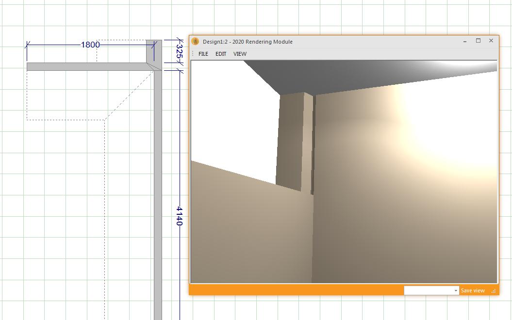

      • March 18, 2020 at 4:51 pm #274637
        Jim Knowles
        Crown Molding on walls with different heights. See the picture. Crown & base moldings are a huge part of our more upscale designs. Cannot show this customer what their new kitchen will look like against their 8″ crown molding at the ceiling.

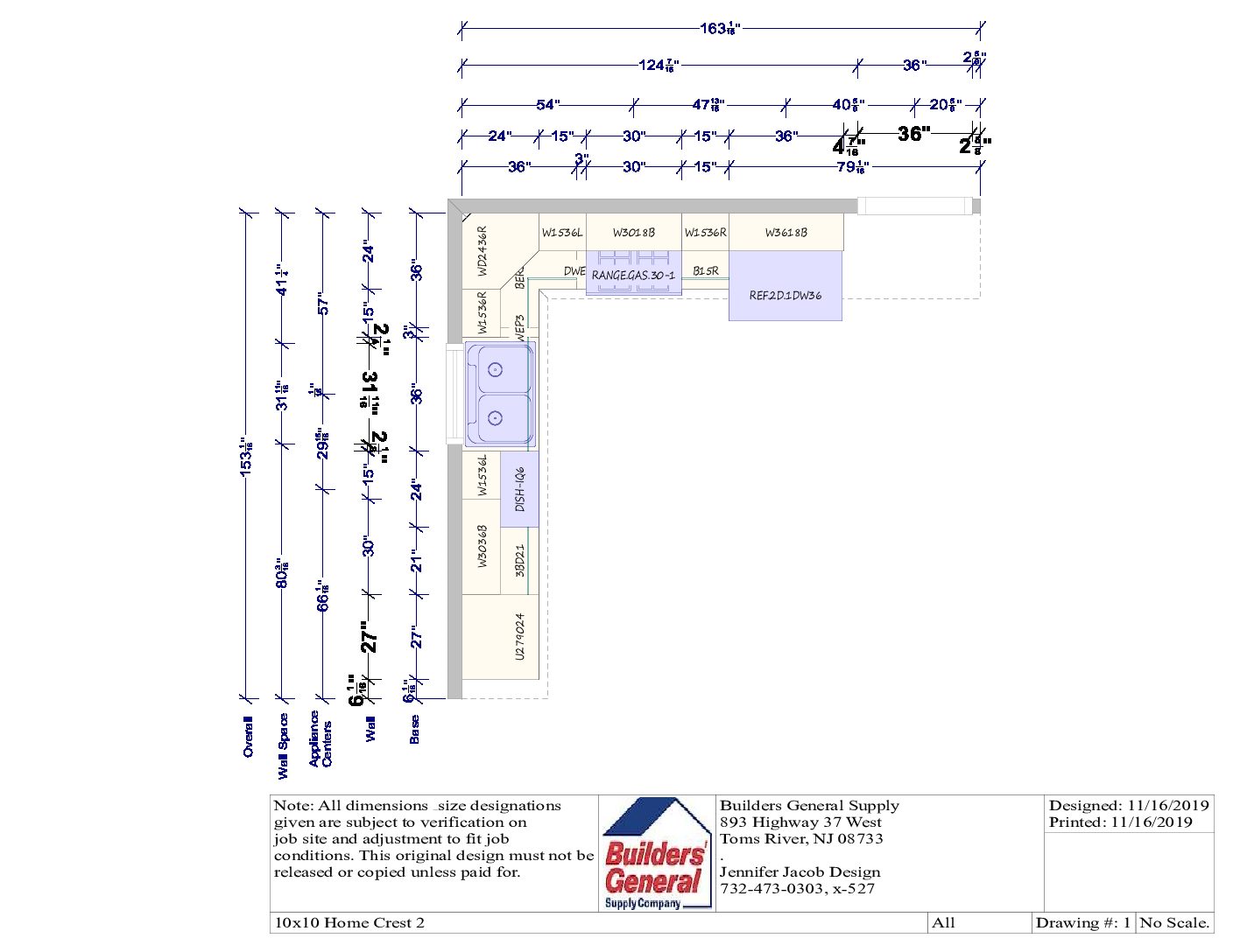

      • January 12, 2021 at 1:05 pm #313278
        Kelly Smith
        I would love tools that make it easy to create NKBA standard drawings, including layouts that function with 11×17 paper, the ability to create your own title block, proper centerline dimensions & etc (study the guidelines and make it easy). You guys are supposed to be the best. You are fine for pricing & rendering, but not for install drawings.  I have purchased another software (CA) for my install drawings in NKBA standards as 2020 doesn’t make it easy. We are WAY more efficient with it – even having to input the design twice!!! Many of my manufacturers have 3rd party pricing software that I am forced to use anyway. What will be the point of 2020 if I have to price there and do my NKBA install drawings in another program? You guys need to catch up.  You have been doing good for years, but you have new GOOD competition. Don’t rest on your laurels.
        • January 12, 2021 at 2:45 pm #313298
          Jennifer Stewart
          I 100% agree Kelly.  2020 needs to catch up in the standard drawing area.  I find it very annoying how the dimensions are so messy.  I will add my own only to have those deleted.  Multiple lines of the same dimension, dimensions on top of dimensions.  Very messy and time consuming.  Labels should not be on top of each other and having the ability to align them all at once would be nice.  One at a time to move dimensions and labels takes way to long.

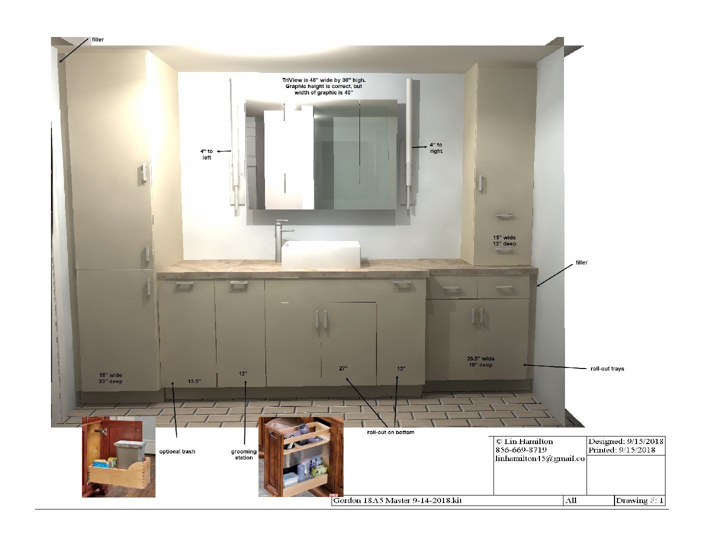

      • September 16, 2022 at 2:06 pm #375433
        Doug Anderson
        I would really like to see added workbooks for a single project. I imagine it working a bit like excel, separate tabs at the bottom, used to create different spaces in the home while simultaneously allowing you to select the catalog style for that area. I would like to be able to name the different areas, so when I print elevations or layouts the name of the space will show below.
        Printing overall is a nightmare. Sometimes whatever I’m printing is scaled way too small. I use the scaling tool to make it larger and then it runs off the page and there is no way to force it the direction i want it to go. Once you’re in preview you can’t choose, fit to page, or any other standard tool used for printing. I am frustrated daily because of this.
        I’d also like to see the drawing layout have an option for landscape layout.
        • September 16, 2022 at 3:05 pm #375434
          Hi Doug,
          Just to clarify, there is a way to move the drawing when in print preview. When you have the print preview open, click and hold on both the left and right clickers and your mouse will turn into a fist. When you see the fist, you can then move the image anywhere on the print page.
          Also, you can print the drawing layout in landscape and portrait. When you have the drawing layout in front of you, click on File > Print > Page Setup .. From there you will be able to change the orientation of the page from portrait to landscape.
          Hope this helps.

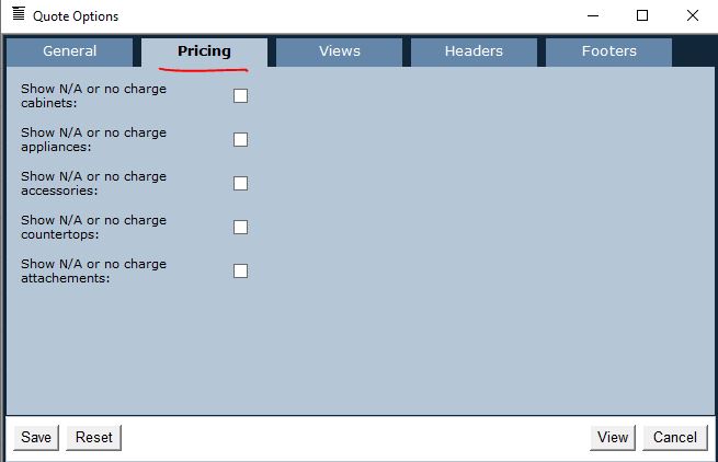

      • January 9, 2024 at 2:34 pm #435890
        Brett Nelson
        Install Points exported on Simple Export
        We use install points to determine the price for installation and having that data when you export the design would help in other areas of our business. This used to be a feature in v10 but was removed and I’m not 100% sure why. Below is the only note I could find that referenced install points.
        pubfilexfer2020prod.z20.web.core.windows.net/doc/v10/20-20_design_update_10.5.0_release_notes.txt
        Install points and transportation should not list as line item

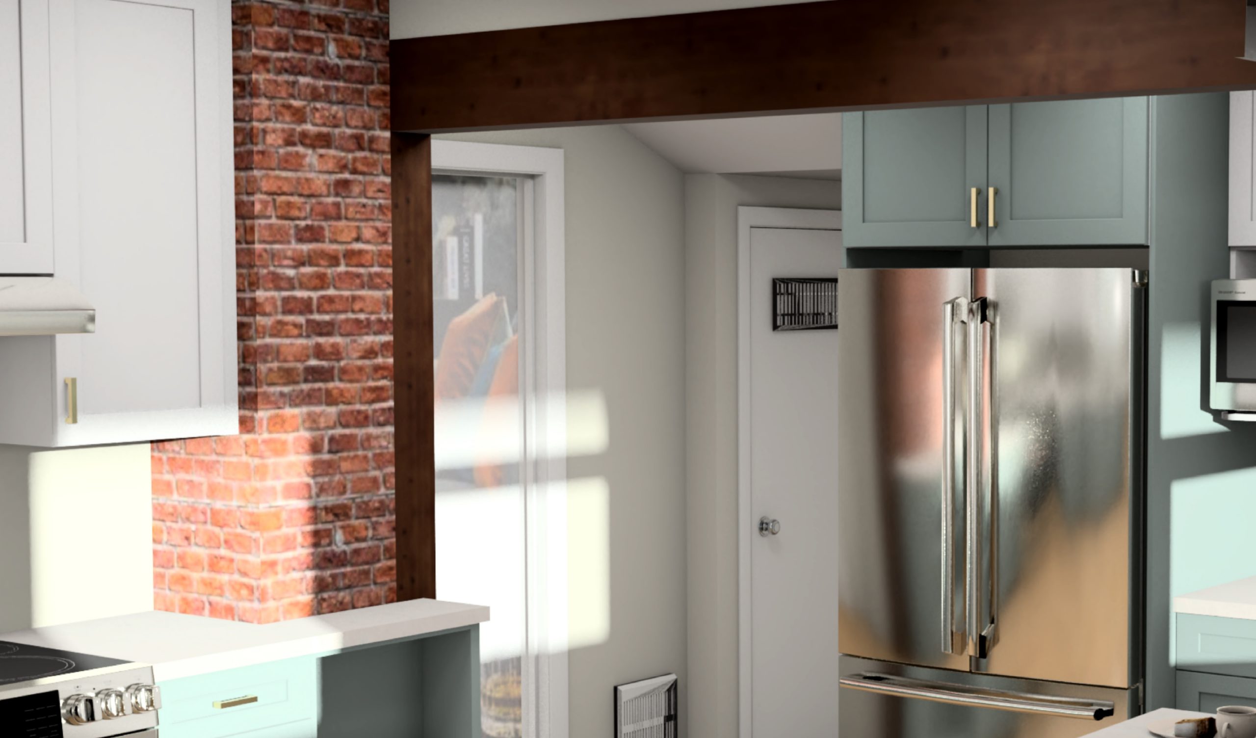

          Ron Russell
          I found the 360 pano under file of the perspective window. I cant get past the rendering, it completes, but what is next for me to do? Is there a video showing the entire process step by step?
        • December 2, 2019 at 10:14 am #261001
          Ron Russell

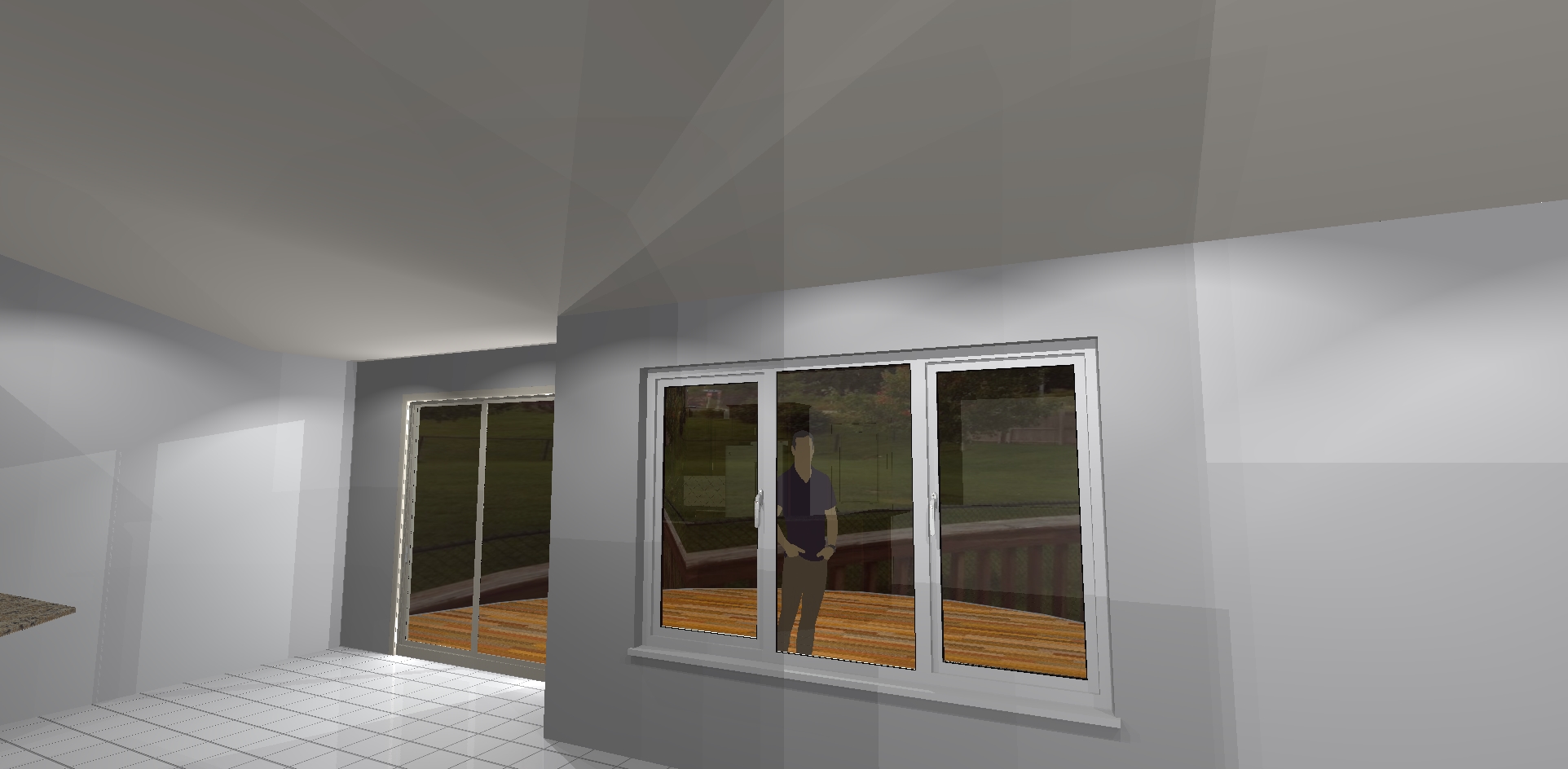

          patience, still have questions.
          https://panorama.2020.net/view/xp8ppub6fko4lfpa9rxgpq/
          Sometimes the ceiling shows correct, sometimes not.
          see attachments.
          The L shape wall group is not attached to the ceiling.

    • August 22, 2018 at 11:54 am #201059
      Lin Hamilton
      Pilot Pro
      A. I would like to select which catalogs will appear in my printed quotes.  It is very frustrating to click “save paper”, then have 14 pages printed list (1) everything from the Decorative Catalog, (2) everything from every appliance catalog used, (3) all the under cabinet lighting, and so forth.
      Yes, I can select page numbers, but even that takes time.
      B. Why does there have to be a final tally page?  If “paper saving” is checked, why put this on a separate page.
    • October 19, 2018 at 1:35 pm #209459
      Chris Setlock
      Please, please, please give us control over the numbering system.
      2 months ago, I had to make some changes to an order after I’d placed it with my cabinet vendor.  Making those changes in 2020 caused the program to renumber the legend and the order forms, so it was nearly impossible to cross reference everything.
      I spent a full day highlighting, cross checking, and sweating bullets.  I thought I got it right.
      I didn’t. I missed a finished side and an end panel.  Now that the cabinets have arrived, I have a hot mess I have to figure out, and a cranky customer, and an annoyed contractor, and I look like a bumbler.  I don’t enjoy looking like a bumbler.
      So please, allow us to control the numbering.

    • January 8, 2019 at 12:19 am #222780
      Robert
      Renderings would look better if the light properties for windows and doors could be adjusted, dimmed or turned on/off. And the scene lighting needs some help. This setting should adjust the brightness of the room instead of it looking like there are a bunch of  recessed ceiling lights that are too close to the cabinets and the top of the wall cabinets are shaded.  Your door styles could use some updating, most of them are not even usable. Same goes for your hardware. While your at it group them better, all slab then all raised- square/arch/ then  recessed and so on. Group all handles, then all knobs. Some better backgrounds for windows would be nice, pool decks, backyards, beach, lakes etc.  Same for the doors, living rooms, dining rooms, hallways etc..

      As to the light coming in from windows and doors, you can turn it off by going to the window/door’s Light Properties and changing the colour of the light to black.
      Sometimes I’ve added a little ambient light coming through the window by turning off the light, then placing a couple of pucks behind the window pointed in – but that’s a pain – and you have to be careful you don’t get a proximity glare on your Scenery Panel/Background.

      Thank you for the window lighting tip, changing the color to black helped tremendously!

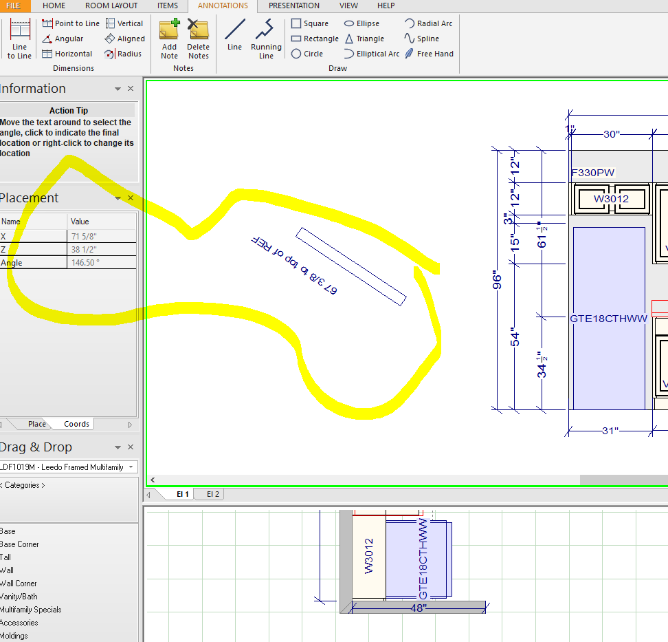

      I sometimes like to highlight an area of the design to the attention to the client – perhaps a potential collision issue, perhaps a bad sight-line, etc – and right now I use the Circle or Rectangle in a bright colour – but I would love to be able to FILL those geometric shapes with a translucent, soft colour – like a virtual highlighter pen –
      At the moment, if I flood the shape with colour, it blots out anything beneath it – but I’d like a soft, transparent colour overlay.
      A gal can wish, right?
      Cheers,
    • April 13, 2019 at 1:30 pm #234238
      Lin Hamilton
      Pilot Pro
      Ariana,
      I take everything (floor plans, elevations, renderings) into Snagit, a screen capture program.  There I can add notes, great arrows, high-lighting in different colors and transparency and so forth.  I can match colors to cover up minor color flaws.
      Spoiler alert: I am related to the CEO of the company which sells Snagit, but I was using it long before she took the job.
      If I did it correctly, I attached an example.

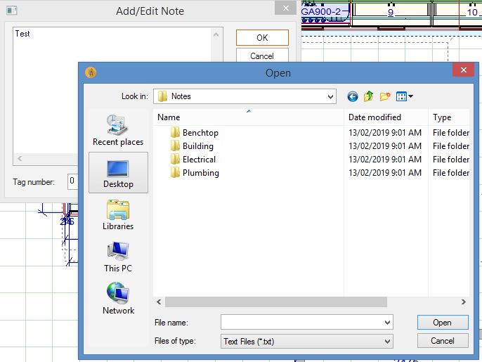

      For PDF creating, annotation etc, I recommend PDF X-Change – we have been using it for years, have a company license and it is awesome. Quick, easy and so many features.
      However, for general 2020 work, most of my designers use the 2020 notes feature and have lots of standard paragraphs saved as individual notes with file names like:
      1. Plumber – Sink & Tap
      2. Plumber – Dishwasher
      3. Plumber – Laundry
      4. Sparky – Rangehood
      and so on. It’s easy and fast.

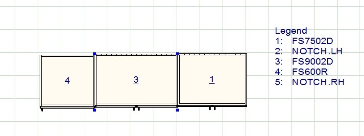

      Can the Legending PLEASE be changed so that add-ons show as an offset item immediately below the cabinet they have been added to. Currently, they show in the order they were added.
      We use (for example) an add-on for when we scallop/notch the left or right side of a cabinet for a sink/coopktop. Ideally we would want the legend to be similar to this:
      1. F7502D
      1.2  NOTCH.LH
      2. F600LD
      3. F600RD
      Attached is a pic of how it happens at the moment.

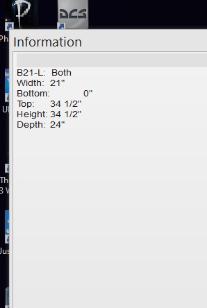

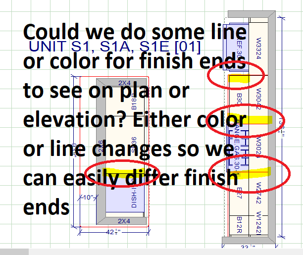

      1)When we mirror a cabinet, finish end doesnt change. I wish it changes by mirror prompt.
      2)I need to see finish ends in layout. Can you just highlight the side just that side may draw with a yellow line, I don’t want any notes if it just highlights it will save 20% of my review time.
      I really pray for you If you fix these issues.

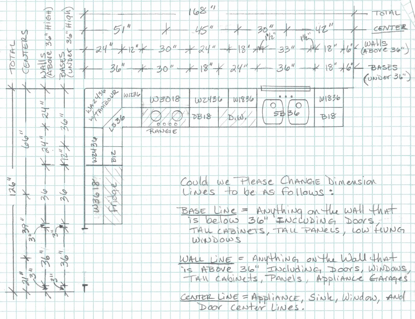

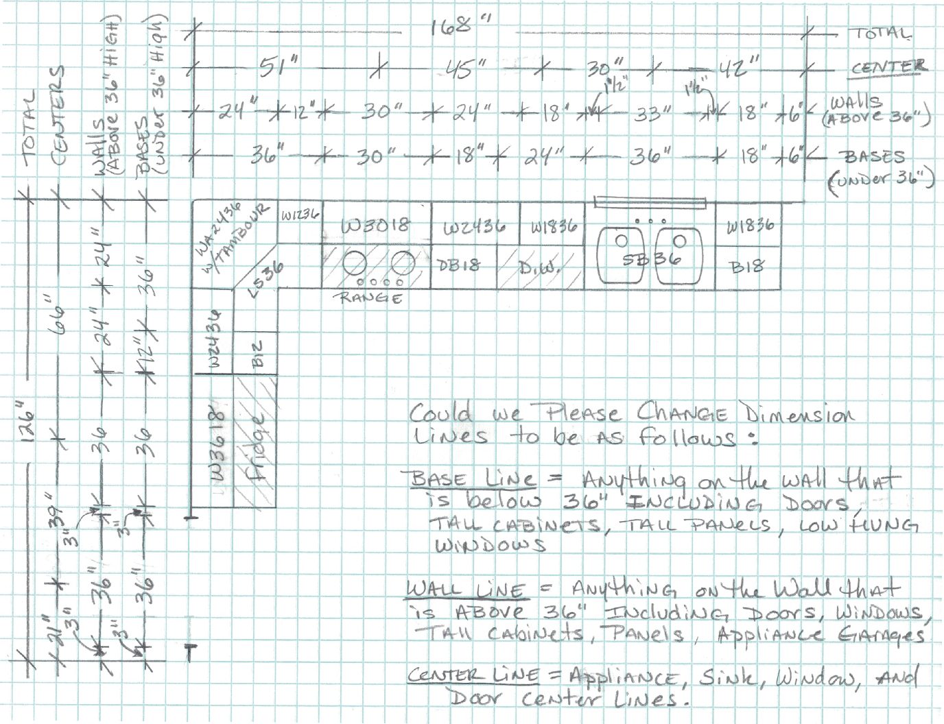

      Jennifer Jacob
      Hi,
      I am wondering if the Base dimension lines on a design view can include anything that is below 36″ (As well as doors, windows, and tall cabinets)…. and the Wall dimension lines can include anything above 36″ (including doors, windows, and tall cabinets).  Currently I can not figure out how to make that happen.
      It would be a HUGE time saver and very helpful to have the distance from a wall cabinet to the tall cabinet or window that is on the left or right show up, or to have the distance from a base cabinet to the door show up. without having to check it manually or calculate it.
      Please see attached print.
    • November 16, 2019 at 12:52 pm #259804
      Jennifer Jacob

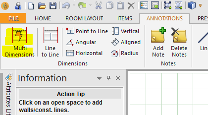

      • November 18, 2019 at 4:35 pm #259958
        Santiago Morales
        2020 Expert
        Hello Jennifer,
        Thank you for this feedback. We took note of this request.
        Did you have a chance to try out the Multi-Dimension tool? Many users have reported that this is a huge time saver to annotated the desired dimensions quickly.
        Thank you,
        Santiago
    • November 20, 2019 at 10:31 am #260197
      Jennifer Jacob
      Hi Santiago,
      Thank you! I Soooooooooo  hope that change will be made.  I’m not sure what you mean by the multi dimensions tool…. Do you mean the “point to line” , “line to line”, or “Angular” dimension tools and the annotation tools??  If so, I do love them, I just think the plan’s outside dimension lines could be improved and would be a HUGE time saver when designing, not to mention it would be less confusing for the contractors who are trying to read them.
      Having a “Base” line of everything that is below 36″ (Including doors, windows and tall cabinets)… and a “WALL” line of everything that is Above 36″ (Including doors, windows, and tall cabinets) will make the space between these items automatically show up on the line so I don’t have to stop and look up the space.
      Not having to stop what I’m doing to use a tool or calculator to calculate the space that is left would make my design time FLY!!
      I’m ADHD and any time I can reduce a distraction from my train of thought, I’m advocating for it. :O)
      So please, please, please look into this. It used to be a feature on Planit Kitchen Design Software.
      :O)  Jen

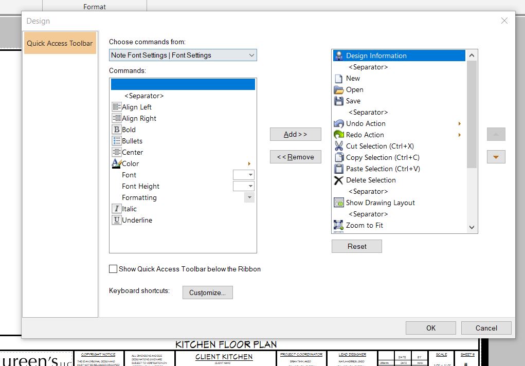

      Kelly Ladd
      -Arrows or leaders.  They are necessary when you move the label of a smaller item like a filler and then want to use an arrow to show what that label goes to, etc.
      -More customization in the title block
      • November 20, 2019 at 2:09 pm #260223
        Santiago Morales
        2020 Expert
        Hello Kelly,
        We can add arrow head by editing the lines (right click menu). Please see attached image. Is this sufficient to you?
        For the Title Block, what additional customization are you looking for?
        Thank you,
        Santiago

      1-A: Easier method of annotating. If I use some of the draw shapes like a line to a cabinet, a circle or rectangle, they are in the forefront (and the click range is wide), so when I try to move a dimension or cabinet, I have to move the annotation out of the way. In an elevation, lines are selected first and shoots 20’ away from the drawing. I try to move it back, but I have to zoom out because there is a very large gap between the line and my curser, so I have to overshoot my curser from where I am placing it to get it to the right spot.
      1-A.1: To be able to copy and paste in an elevation. It defaults to the floor plan.

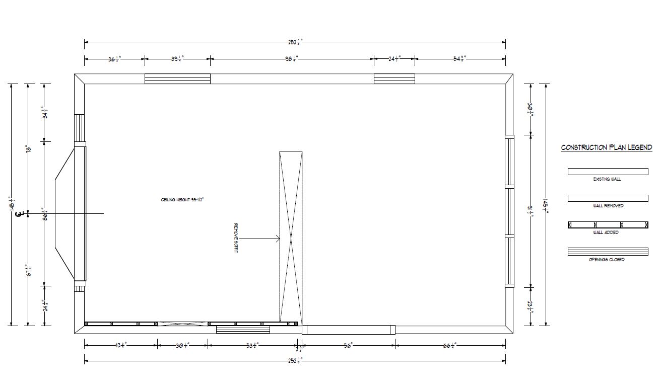

      1-B: To be able to change the color of a specific dimension to help draw the contractor’s attention or color code a set of dimensions to coincide with annotations.
      1-B.2: A better way to show moved or removed windows, doors, and walls in a construction plan. I spend a lot of time creating one by hand or using a supplemental program drawing the 2D plan in Sketchup. It would be great to do it all within the program.
      1-B.3: New shapes for revision clouds, 2D shapes for construction plans and other call outs. I create construction plans for contractors, so the ability to call out revisions easily in the program would be helpful.

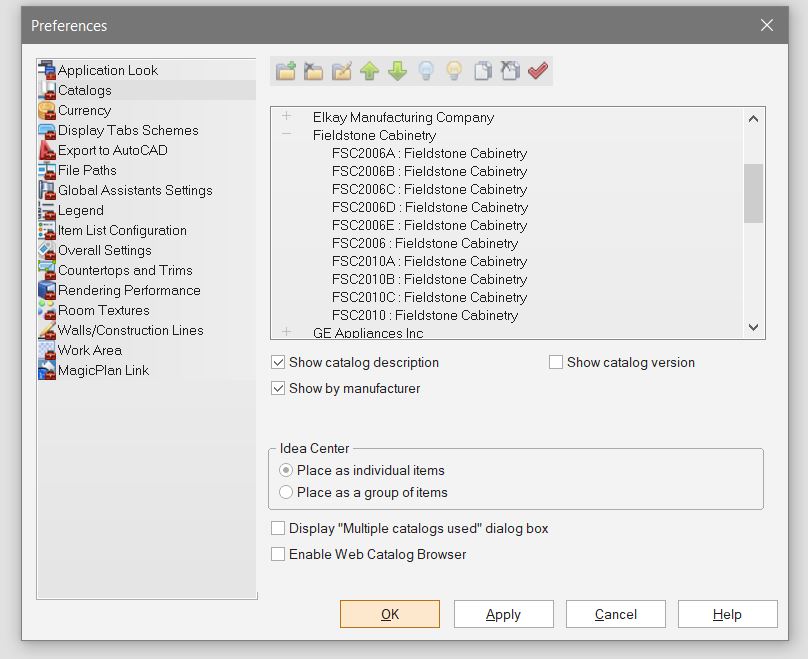

      CATALOG MANAGER:
      I would love to see the Full Catalog descriptions and the complete list at one time.
      Pipe dream, I know.
      • January 14, 2021 at 11:25 am #313396
        Hi Gregg,
        To see a list of the catalogs you have installed as well as their descriptions, open the Catalog Manager and then either select ‘Rename’ or ‘Delete’. These options should show you the names of the catalog as well as the manufacturer whose catalogs they are. See the image below for example.
    • January 14, 2021 at 11:38 am #313409
      Gregg Meyers
      Hi, Kristopher,
      I know that I can see these in either “Rename” or “Delete” functions.
      However, in Ver. 11.12, the names are all truncated.
      I’ve avoided moving to newer Versions until we are no longer “Beta-testers”
      and 2020 truly provides us a stable product that many of us have been paying decades for.
      Thank you for a nudge to move to a newer version.
      My appreciation,
    • January 14, 2021 at 11:54 am #313410
      Kayla Herrick
      Gregg, V12.3 user here. I don’t know if the set up is different in V11.12; check if the following works for you. Open the 2020 Design program (not catalog manager). In the file tab, select preferences. Open the “Catalogs” tab the dialog window.  In that tab, select “Show catalog description” and “Show by manufacturer”. This will organize your catalogs in a hierarchal list in the Local Browser tab. I hope this helps!
    • January 21, 2021 at 11:53 am #314047
      Margaux Bangs
      It would be great to be able to create a set shape for notes. In both the design and drawing layout, if you have a long sentence or paragraph, it would be helpful to be able to create the shape you want that note to stay within.
    • January 21, 2021 at 6:31 pm #314051
      Hi Margaux,
      My users have a lot of notes either set up as text notes using the Save/Open option or (as in your case) stored in a drawing.
      It is extremely useful to have all your most used stuff including standard text notes shaped as you prefer and specific cabinet configurations and most used accessories (chopping boards etc) stored in a drawing that is easily accessible. From there you can just copy and paste into your current drawing.
      My people usually save the drawing as AAAAccessories.kit or something similar so that it shows at the top of the file list. They also have such files on the desktop so they double click it to start 2020 Design up and it’s immediately available for copy and paste.

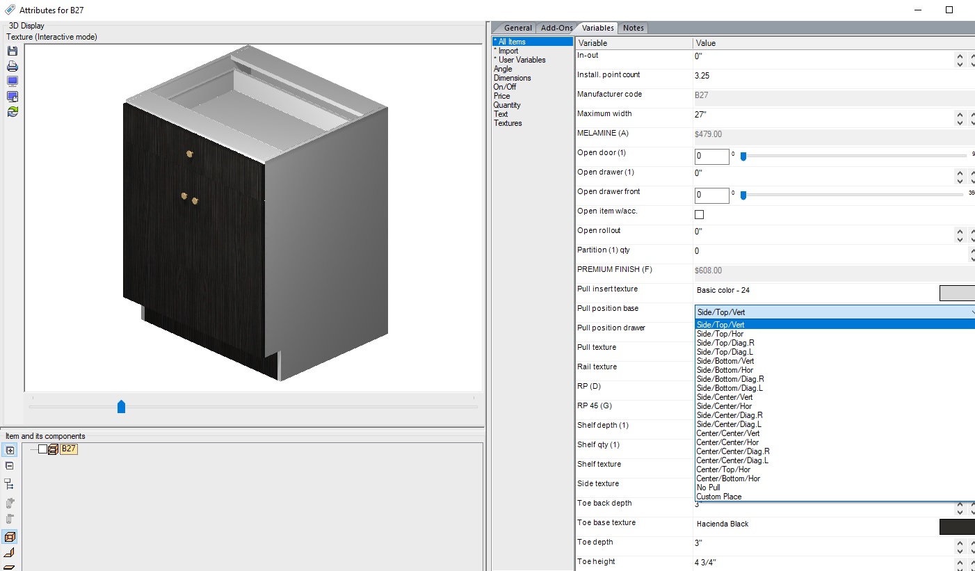

      Re default countertop thickness or indeed any variable that you can set via global attributes, you can just use the template function to make life easy.
      Once you have a template configured and saved with a sensible name, double clicking on the template opens a new design file but with the attributes you previously selected already applied. You could name the template sensibly such as “Shaker-offwhite 30cm-whitemarble.tpl
      I am writing a little guide on this as I speak.
    • February 14, 2021 at 6:56 pm #316597
      Tried to edit the  above but no luck. It seems that Global Attributes shows a very limited variable set and in my catalogs at least, benchtop thickness does not appear. Templates are still handy but mainly limited to textures and styles it seems.
    • February 14, 2021 at 7:05 pm #316598

    • February 16, 2021 at 6:47 pm #316938
      Hi Erik,
      2020 Design has a Multi-Dimension tool that is superb and easy to use and the Display Schemes can be used to give you very powerful control over what is displayed including dimensions.
      Also, texture/colour changes are also very easy to accomplish as well as being able to very quickly and easily adjust lighting, exposure settings etc in renders. Now I’ll be the first to say that the lighting tends to need some more work to get it right but you can really get some very realistic renders. I’ve used Chief Architect and IMHO, the renders come nowhere near 2020 Design.
      So, not sure what you are asking for as the things you have commented on are already there but perhaps in a slightly different format/operation?

        Erik Tornquist
        Mike, Yeah I use the multi-dimension tool often but that’s not quite what I’m getting at. Basically, to click on every line you need to create an outline of measurements; measurements would show up on each one of those lines whether parallel or perpendicular to each other. I’m sure it would involve quite a bit of coding to create but it’s an awesome feature that CA has.

    • February 17, 2021 at 9:49 am #316946
      Jennifer Jacob
      Hi Mike,
      We have been BEGGING for the following changes to the dimension lines:
      A. Everything on a wall below 36″ to show up on a “Base Cabinet” line. This would include doors & Tall cabinet.
      B. Everything on a wall above 36″ to show up on a “Wall Cabinet” Line. This would include windows, doors, and tall cabinets.
      Currently, This does not happen and we then have to waste A LOT of time using the multi-dimensional tool to adjust the dimension lines for our contractors, or we have to calculate it.
      We are looking for time saving option of already having the appropriate numbers show up on our dimension lines.  If you can make this happen, we all would greatly appreciate it.
      Please see the attached example.
    • February 22, 2021 at 8:00 pm #317329
      Hi Jennifer,
      I have a display scheme that allows me to show floor plans where JUST the base and tall  measurements are shown and one where just the wall and tall measurements are shown. I also have the ability to show elevations with just base and tall and then wall and tall cabinets and dimensions (complex designs sometimes means that the installer needs the split detail).
      You could also change your display scheme to use different colours for your base, wall and tall measurements. In the attached example, the wall unit measurements are in Fuschia (red for most men!)
      You can get close to what you want if not perfect.

        Jennifer Jacob
        Thanks Mike,
        I am really hoping they will find a way to include everything above 36″ (all wall, tall, windows, and doors) on one line, and everything below 36″ (All Base, tall, doors, low hung windows) on one line….   It would just be so much easier for everyone to read it, and save me a lot of time trying to adjust all the dimension lines that show up on my plan to be readable and less confusing.

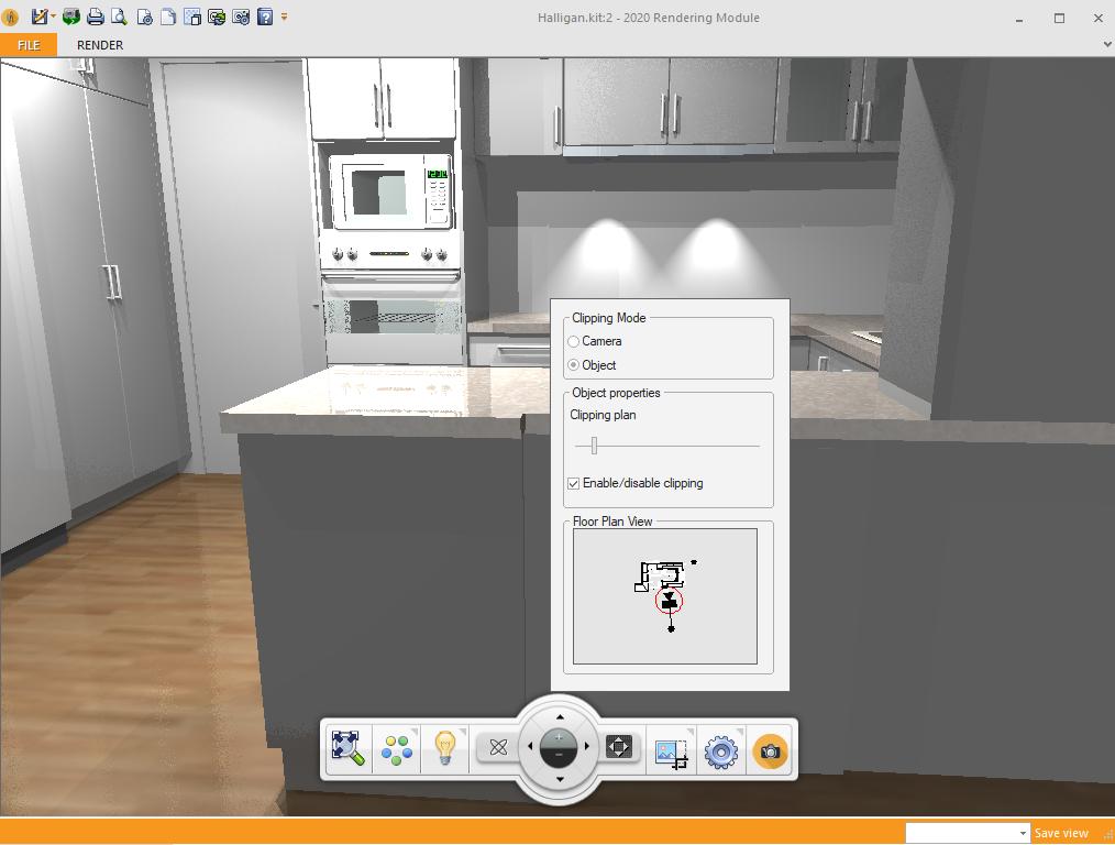

      I would like to be able to hide individual walls from view without having to move them; nor adjust the camera to the point of an oddly skewed perspective.
    • March 1, 2021 at 6:15 pm #318148
      Hi Michael,
      You can use the Clipping Tool in the render view to ‘disappear’ walls.

      I have a list of over 1000 possible improvements, but I’ll start with just one. Make the legend numbers match the item list numbers.
      • July 7, 2021 at 5:32 pm #338308
        Santiago Morales
        2020 Expert
        Hello John,
        The item list number and the legend number are 2 different numbering schemes filling 2 different use case. Why do you need them to match?
        Thank you,
        Santiago
        • September 1, 2021 at 5:26 pm #344602
          John Nelson
          The legend on a floor plan or elevation should DEFINITELY match an item list or any BOM report to prevent confusion (which reminds me of a second point I’ll bring up at the end of this response). I have had many conversations go like this… CLIENT: “I need you to make a change to number 4 on the floor plan which I think is number 37 on the order report. Can you verify that this is the same cabinet and make the appropriate changes. If not, can you tell me which cabinet number 4 is on the cost report and how much it is?” This results in a lot of wasted time on my end and the client’s end with emails.
          Second note. Every time I change a cabinet or save a file after making any change, the legend numbering changes which causes all sorts of confusion when comparing past revisions. The numbering no longer matches. Cant, it just stay the same? Example: Wall cabinets>Base Cabinets>Tall Cabinets>Accessories moving in a clockwise direction

    • June 10, 2021 at 1:30 pm #335689
      Ariana Thompson
      Could we get a GLASS textures in the Common texture catalogue that is only about 25% as reflective, but still transparent?
      Often I get a LOT of glare in glass fronted cabinets – and removing the glass makes it looks like….it has no glass – obviously.  So I end up dialing down my Ambient light etc and then I have to drop a whole bunch more lights to compensate.
      I don’t necessarily want frosted glass – just clear glass that is not as reflective.
      Cheers!
      • June 10, 2021 at 2:00 pm #335774
        Willesa
        In 2020 training, we learned to “dirty” the light to make less glare. This can be done by manipulating the lighting settings in perspective. Also, do not render an open room. If it’s open, add walls around, it will help with stainless appliances too.
    • June 10, 2021 at 4:33 pm #335806
      Ariana Thompson
      Hi Willesa,
      All done – and both excellent tips.  Though I do like a bright, sunny room.  While I ADORE the renderings I see some gifted folks do with 2020, I do find most too dark for my taste.  I want my renders to look like a design magazine – and they’re bright!
      This photo for example – I had to dial down all the windows to almost black, and dim the ambient light to the point where – while usable – I do not like how dark this render is. All so the glass in those uppers weren’t blinding white with reflection.
      • June 10, 2021 at 5:54 pm #335893

      This may seem small, but I would LOVE the ability to position the default pulls on cabinets on the TOP EDGE, BOTTOM EDGE, or SIDE EDGE to create the look of fingerpulls.
      Fingerpulls are very popular here, and I end up either eliminating the pulls and drawing them on after, or creating DOZENS of thin, flat, shapes and floating them at every door and drawer!
      Cheers! Ariana
    • July 22, 2021 at 11:26 am #339388
      Ariana Thompson
      Hi Willesa,
      Not that I’ve been able to find. – And Amerock only works for one of the catalogues I use.
      I basically use the default pulls 99.9% of the time.
      But thanks Willesa!
      • July 22, 2021 at 11:30 am #339389
        Willesa
        I’m not sure which catalog you’re using, but most of the cabinet catalogs I used allows me to change the size (width/height) and X Y positioning of the default pull. That feature isn’t available with all cabinet manufacturer catalogs though 🙁
    • July 22, 2021 at 12:31 pm #339392
      Ariana Thompson
      I can change the height and width, and for positioning all my cabinet company catalogues give me a dropdown with choices like Side/Top/Horiz, Side/Top/Vert, Centre/Top/Horiz, etc
      Because all my cabinet companies are like that – I figured that was a 2020 thing.
      • July 22, 2021 at 12:35 pm #339394
        Willesa
        Nope, I think it’s per manufacturers, but I agree, it should be available as default to be able to move these, because in real life they can go wherever we choose. See my image, my main line allows repositioning anywhere on the door.
    • July 22, 2021 at 12:46 pm #339404
      Ariana Thompson
      Interesting!
      BOTH my cabinet companies; one a national brand, and the other a smaller local maker, have an identical dropdown for pulls.  It must be an option offered to programmers from 2020 for them both to be identical.  Oh – and the option “Custom Place” does nothing. -sigh-

      • A check-the-box style choice in the “quote options” screen to select which catalogs you want included on the quote report you’re running; or
      • A simple choice in the “quote options” screen to automatically list each catalog individually on its own quote report.
      • August 12, 2021 at 12:17 pm #342093
        Hi Jacob,
        When creating a quote, it will automatically split up the multiple catalogs that you may use in a design.
        For example, I’ve created a design using 3 catalogs.. SAMPLE_E, SAMPL_E2, and SAMPL_E3. I have also added an appliance unit from the subzero wolf catalog on the cloud to show how to not make the pricing appear in the quote.
        I used sample_e for all of my base units along the wall, I used sampl_e2 for the wall units along the wall, and I used sampl_e3 for the island. Below I have attached a PDF of the quote to show how the report splits all catalogs into their own groups and how it provides pricing for every individual catalog. Not only that but it will also let you know the styles and finish per catalog.
        In the report you will notice that you cannot see the pricing for the Appliance. I have attached an image to show you where in the Quote Options you can remove the pricing for them. I have also provided an image of what all 3 catalogs and the appliance look like in the rendering.

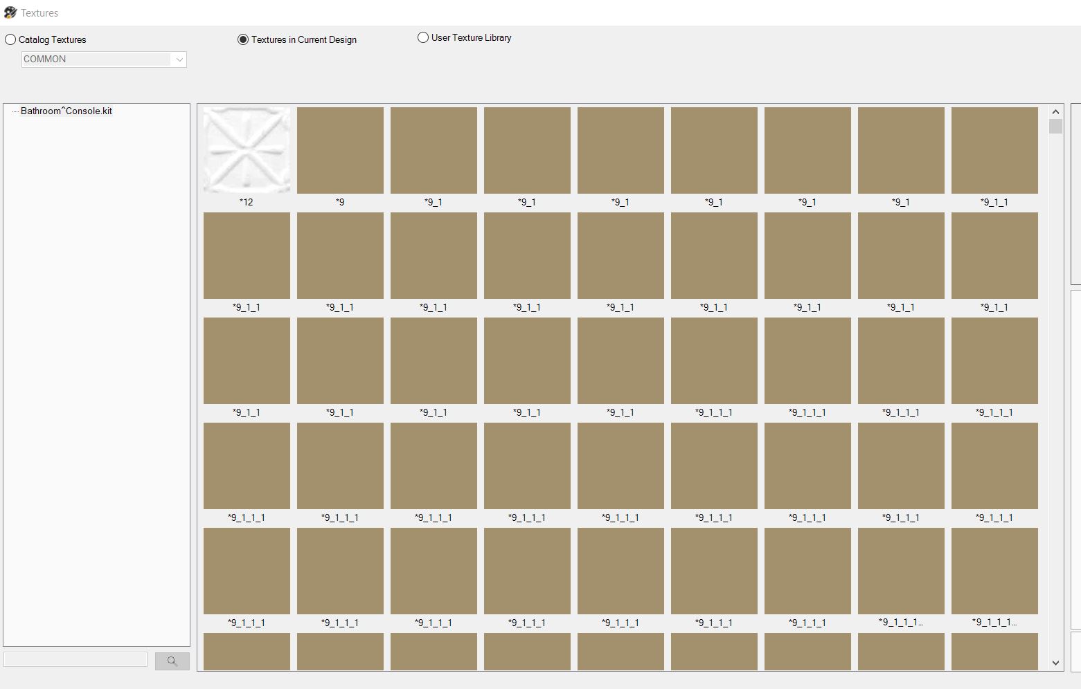

      I am using Design Live 12.5. I pulled a Sub Zero refrigerator from the cloud browser. When I opened the configurator to select a cabinet style door panel there are only 5 piece door styles in a handful of colors. The door styles have different names but they all look the same except the color. It would be wonderful the configurator could allow up to access the cabinet door styles and colors of whatever cabinet catalog we are using in the design. At the very least, more door styles (including slab) and access to the original 2020 attributes textures to select a custom texture would be better than what is offered currently.

    • August 12, 2021 at 12:23 pm #342130
      Hi Peggy,
      The configurator was created to make sure that you follow the catalog guidelines made by that manufacturer. They will only provide options that they offer.
      If you want to add custom textures to appliances, then you can download the file based catalogs from 2020spaces.com or 2020.net and that will allow you to make the changes from within the Attributes section.

      -Placing a line -straight, circle, curved, etc…  Try clicking on any item that’s within 12″ of that line and it’s impossible. The ‘line(s)’ are always selected no matter what you click.  Same thing goes for items around measurements. If a measurement line is within 12″ of a item, that item can not be selected.
      -Placement within a space issue. To give an example:  If there is a space between (2) cabinets of 12.5″ and you try to bring over a 12″cabinet into the space, you’ll see the ‘magnet’ icon show up and when attempting to drop the item into the space, even if there’s enough space for it, it won’t place there but place on the otherside of the kitchen layout. This happens often with even bigger spaces that gap >2″ of the item that’s being placed.

        When you place a line or a circle, etc. Instead of left clicking to select an item, right click over the item you need and select it that way.
        You can move dimension lines that have more than 1 dimension, right click over one of the dimensions you wish to move and select the longest length, it will move all of the dimensions on that row together.
        The only issue I’ve had with not being able to place a cabinet in a space where I show I have enough space is where there is another item interfering with the placement. You can avoid this by turning off collision (bottom right corner).

      Your third issue, do you have “collision” turned off?
      Kayla
    • December 14, 2021 at 8:19 pm #353214
      Erik Tornquist
      Thanks Willesa & Kayla, I had NOT turned collision off. Consider it absolutely done!

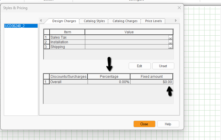

    • May 26, 2022 at 12:10 pm #367878
      To add the ability to set a shipping charge per cabinet.

      Am I the only one that has this problem?  I have a devil of a time making my Notes on the Floorplan STAY in the Countertop and Architecture Tabs.
      We have a “New Design” kit file that has a bunch of standard Notes on the floorplan already in the various tabs, as well as having a cube, a sphere, some cylinders, etc.  We keep it saved with “1” at the front of the filename so it stays at the top of the kit file list, then when we start a new design, we open it, rename it, and start to design.
      Those tabs ALWAYS seem to have no notes, until I leave a new one, copy and paste it, then the old ones start popping into existence again.
      My “Wish” would be for Notes that don’t disappear! LOL!  Now we ARE using  V12 – so maybe this is addressed in V13 already? Or we’re the only one with this issue?
      Cheers,

        1. YES! Slab size calculating would be a big help.
        2. Better Camera clipping in the render window. Object clipping is so much better, slider is easier but that camera clipping slider is a pain. Not only is the whole design clipped after moving the slider 1/4 of an inch, but the points of clipping jump way too much between each other.

      Ariana Thompson
      Morning All!

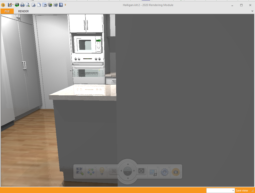

      Thanks to help from this wonderful forum, I know I can turn off the “bright fog” in windows off by dialing the Natural(Realistic) light in Renders down to zero – but the downside of that is you cannot have visible Sun.  I love visible Sun for really giving a room life!
      There is also, for some reason, the same “bright fog” in open interior doorways and wall pass thru’s.  Now, I LIKE the bright foggy look in windows, as that’s more realistic to what photos of kitchens look like in magazines; the view out the window is always whited-out/overexposed.  But my wish would be 1) to be able to toggle it on and off, because it’s not everyone’s thing, and 2) not having it in interior doors/open doorways/wall pass thru’s.
      The annoying thing too is the beams of sunlight coming through the room when the sun is
      “on” HIT that “bright fog” in the doorway – so my open doorway to the living room looks like it has sandblasted glass.  The beams of light hit the opening like it was a surface (see attached image)
      Cheers!

        Hi Ariana,
        Regarding the lighting emitting from the doorways, this was an issue in the version 12. I have tested the doors in both of the latest versions of 12 and 13 and it seems to have been corrected in version 13.4
        Below I have attached renderings taken in version 12 and 13 to show you the difference in lighting.
    • July 19, 2022 at 9:58 am #373260
      Ariana Thompson
      Many thanks for the head’s up Kristopher~
      Looks like we need to upgrade to V13!  Although reloading all those catalogues makes me cringe! LOL.
      Cheers, A
