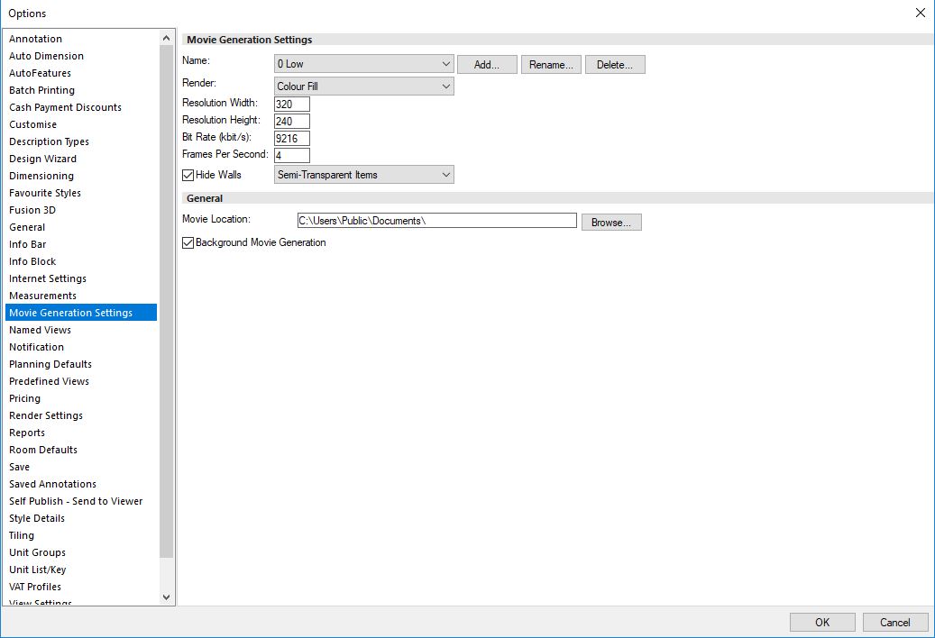

Could you please confirm whether these frames are appearing as black in the “Configure Movie” creation screen where you select the “frames”/”view points” to add into the movie?
While designs are being edited a local copy of this is created on your system and the movie files themselves are generated based on the options configured in “File > Options > Movie Generation Settings”. You may be able to modify this if you use any redirected folders to target a local directory on your computer to test further.
If you are still having issues after changing the movie directory in the options to a local folder, please feel free to call through to our support line on 01233 635 566 and we can arrange to connect up to your machine to investigate this further for you.
