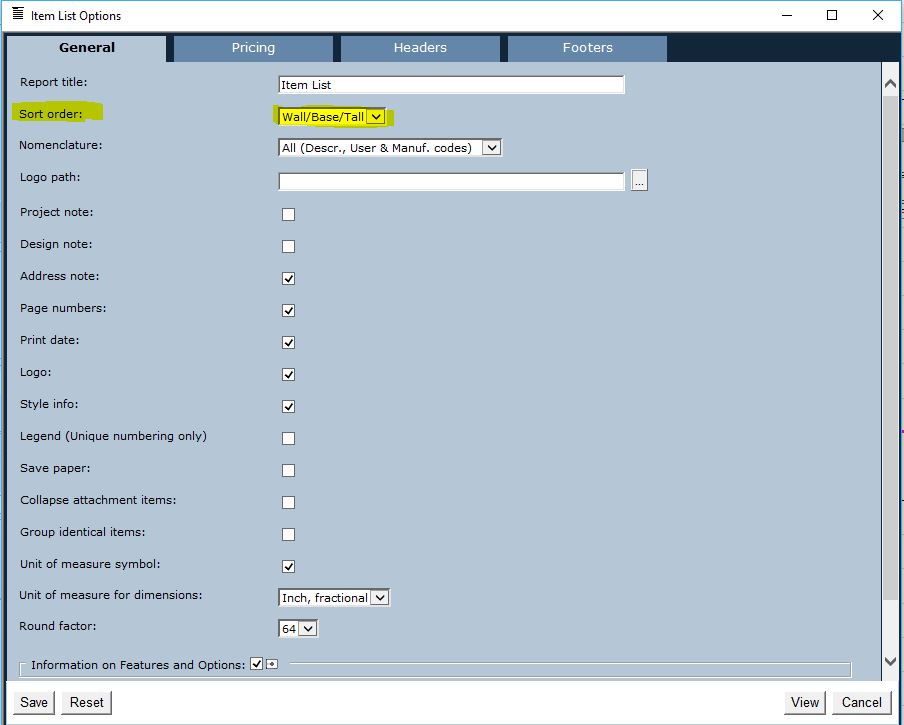

Hi Mark,
With the Item List, you would not be able to achieve it going in a clockwise fashion. The best alternative I have found is setting the report to Wall/Base/Tall.

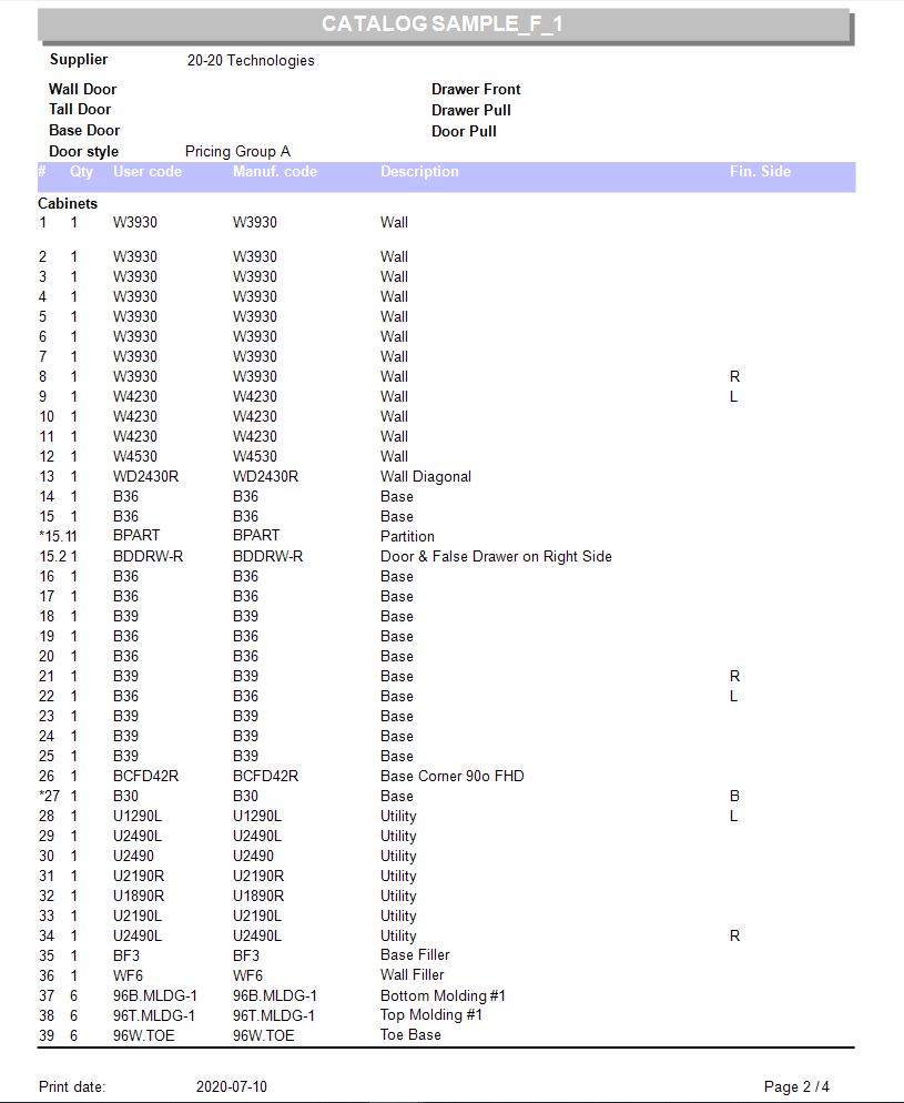

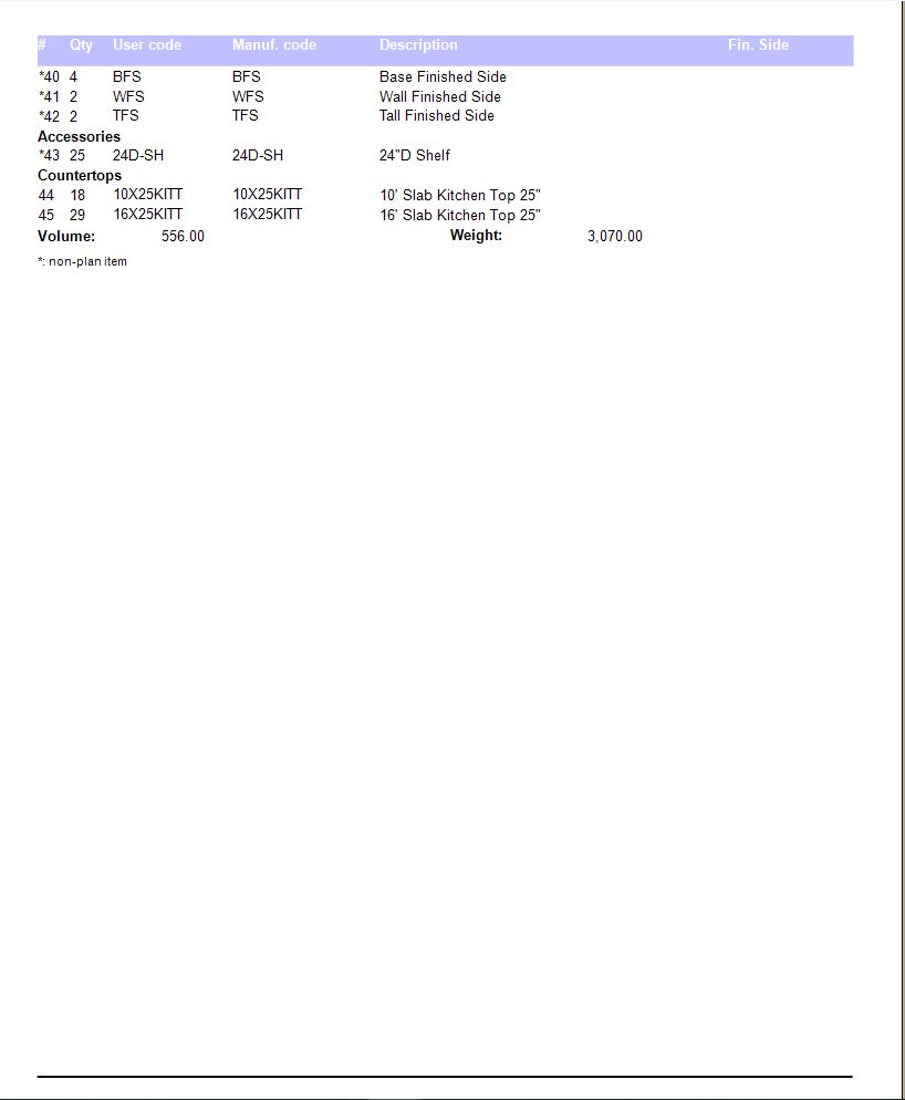

If the report is set as stated above, then the report will appear with all the wall units first, base units second, tall units third and then fillers, moldings, accessories and then counter tops.
See attached files for an example of the Report.
