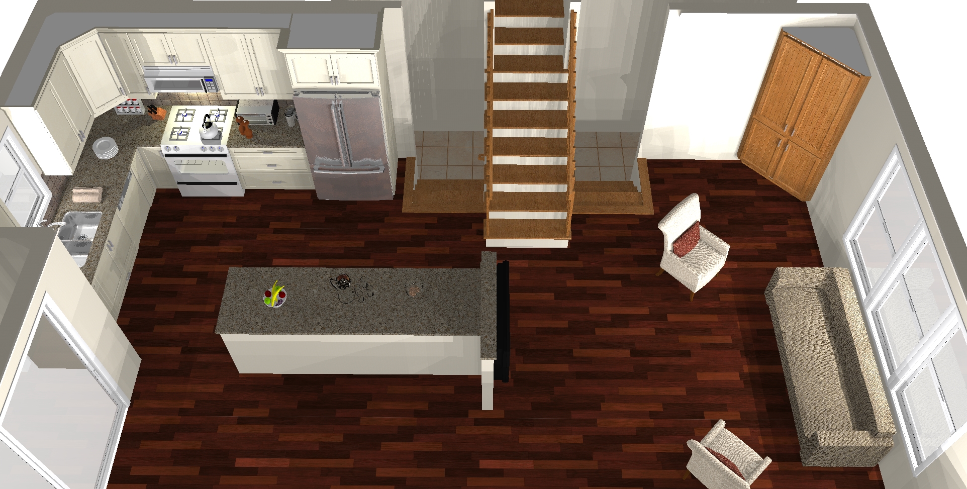

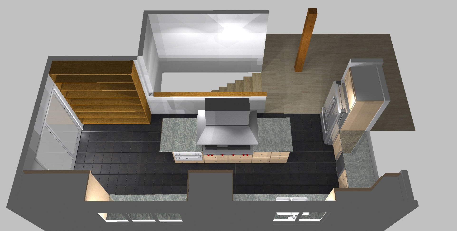

July 5, 2016 at 9:22 am #94294Chris SetlockParticipant
I did a kitchen last year that had a prominent stairwell going down, though the relevant space was all on one level. Still, it needed to look right.
What worked for me was to set the floor to transparent, then make a new floor using the surface tool, being careful to leave the rectangle of the stairwell open. Once that was done, I placed a set of stairs below floor level, with the top lined up to the edge of the opening. It wasn’t 100%, but it looked close enough to pass muster.
