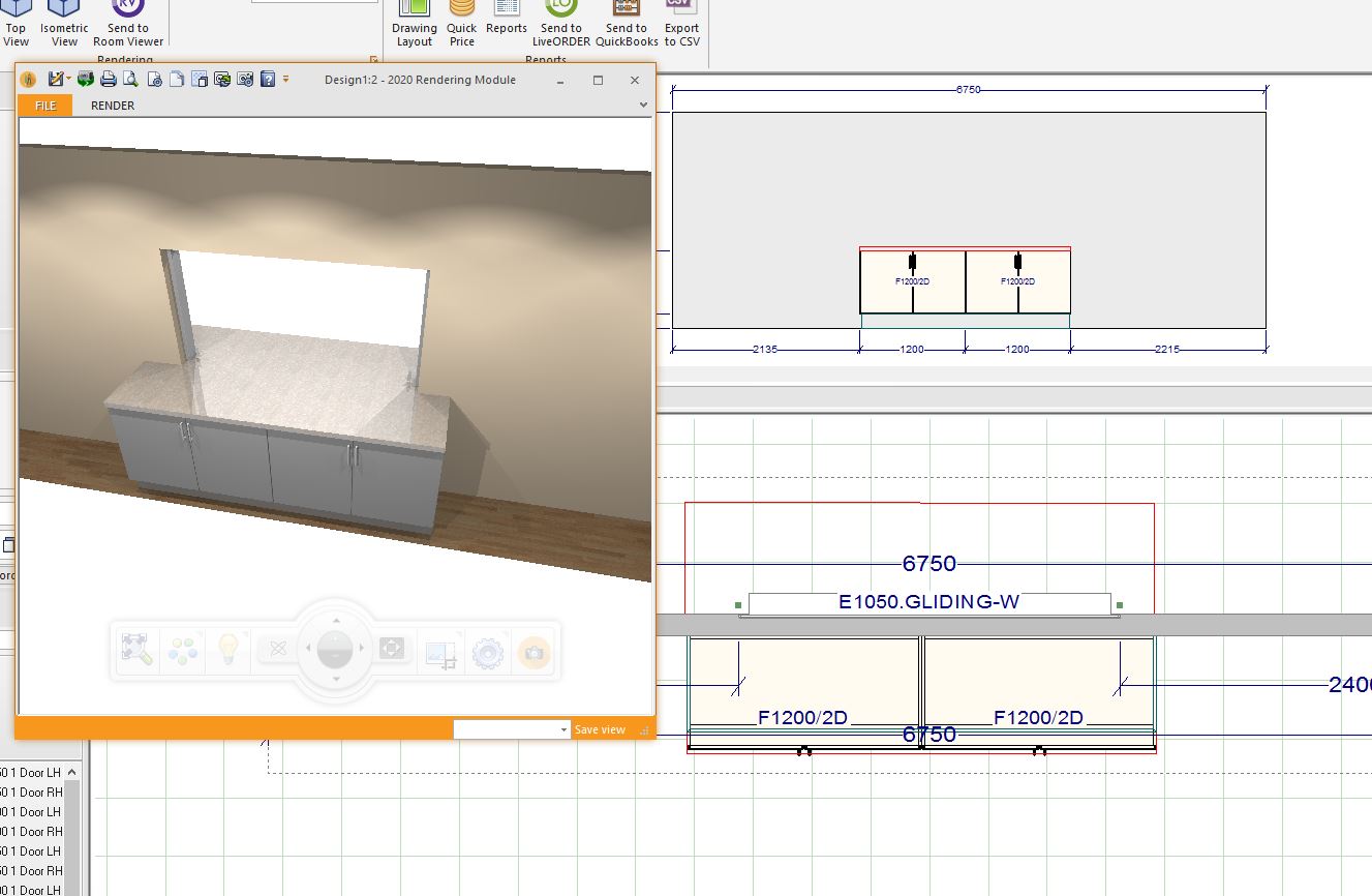

      We have a similar issue. We often come across situations where the benchtop fits into the window space (we call this a reveal). To get this to look right, we always used to offset the window towards the outside of the wall (see image).
      When we add a placement zone for the outside (when we use it as a Servery Window eith cabinets on the outside for example), the window disappears on the internal elevation but shows on the external elevation.
