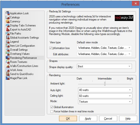

February 23, 2016 at 10:27 am #75688James BarrParticipant
Just to update everyone. After spending over an hour with 2020 tech support and them giving me the conclusion that it was windows 10 and nvidia’s drivers, I spent some time looking around the preferences and found a box for shape display quality that was set to draft from install. Changing that to best fixed all problems. My renderings look like night and day now. Thanks for everyones input!
August 14, 2016 at 2:00 pm #98118Bill Hart, AKBDParticipant
Hey James… so where was this box?
August 14, 2016 at 8:29 pm #98119Mike LangensiepenPilot Pro
Preferences, Rendering Performance, Shapes (in the midddle), Shape display quality
Set to Draft, Best or Normal depending on your graphics card/required rendering speed.
See attached screen capture
