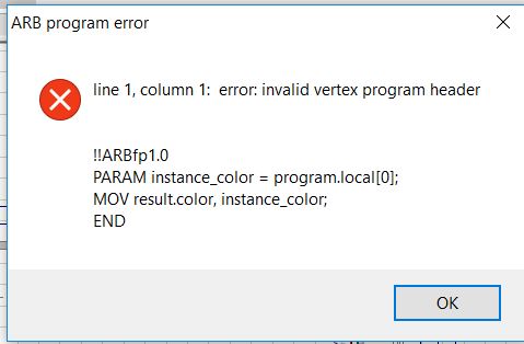

ParticipantI copied a JPG of a countertop from the internet and put it in my user library. I now get this message: ARB program Error..invalid vertex.
I deleted the item out of my design, but it is still happening.
Anyone familiar with this problem?

ParticipantI think I have seen that before. Are you using a custom image or texture? One that might be larger than 512 x 512 pixels?
I think when I used some really large texture .jpgs is when I saw that message.

ParticipantIt might be effecting the design after you delete if that texture still shows up in the Textures in Current Design tab for the attributes.
I don’t know if deleting it from there would help, but you could try that.
August 3, 2017 at 5:10 pm #141337
Neil WilsonParticipantHi Darby,
The ARB issue is often resolved by resetting your registries. You can do that from Maintenance Tools. It could also be a bad texture. The user textures are found in C:\ProgramData\20-20 Technologies\Custom materials\Root. The folder names are gobeldigook but you can find the last one created by date. Deleting the texture may also resolve the issue.
