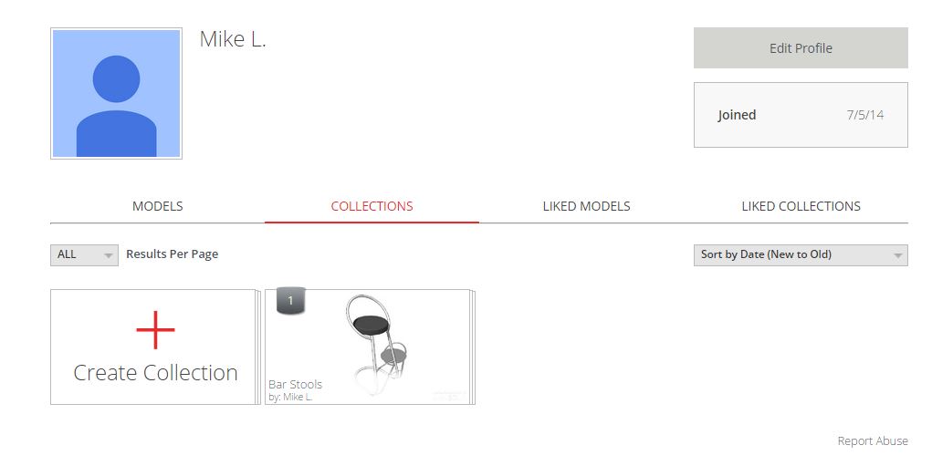

      This question was asked in another forum as well but I’ll re-itererate some of the comments here as some may find it handy – there are a LOT of Sketchup items that are just not available in the Cloud catalogue.
      Sketchup Warehouse allows the building of Collections which can be shared. I recommend doing this in a normal browser as it is a lot quicker. However, it is not enough to simply drag items to your Warehouse collection as if they are removed from Warehouse they can also disappear from your collection. It is very handy that 2020 allows you to log into the Warehouse from the import screen as this allows you access to your Warehouse Collections.

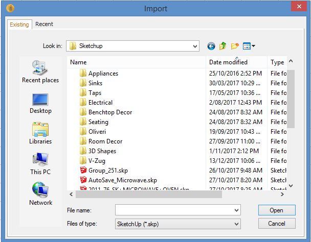

      However, I recommend downloading ALL Sketchup items that you are interested in and organising them in a local folder (or shared folder if you have a network shared drive). This way, they are ALWAYS available even if deleted off Warehouse.
      Once you have your collection organised on your local hard disk, simply sign into Warehouse (free) and upload them into your collections. This ensures that if you are working away from the office, you still have access to your Sketchup items. Also, doing this avoids the issue where (if the Sketchup item has been ‘dragged’ from Warehouse), if the original creatore removes it, it might disappear from your collection. Downloading then re-uploading makes the item ‘yours’.

      The answer is to download the Sketchup items and keep them in a LOCAL directory on your hard disk – once there, they only get deleted if you or another user on your computer deletes them. Yours forever more!  All you have to do is to choose the import option, change the filetype to skp and then navigate to where you stored them on your local storage.
