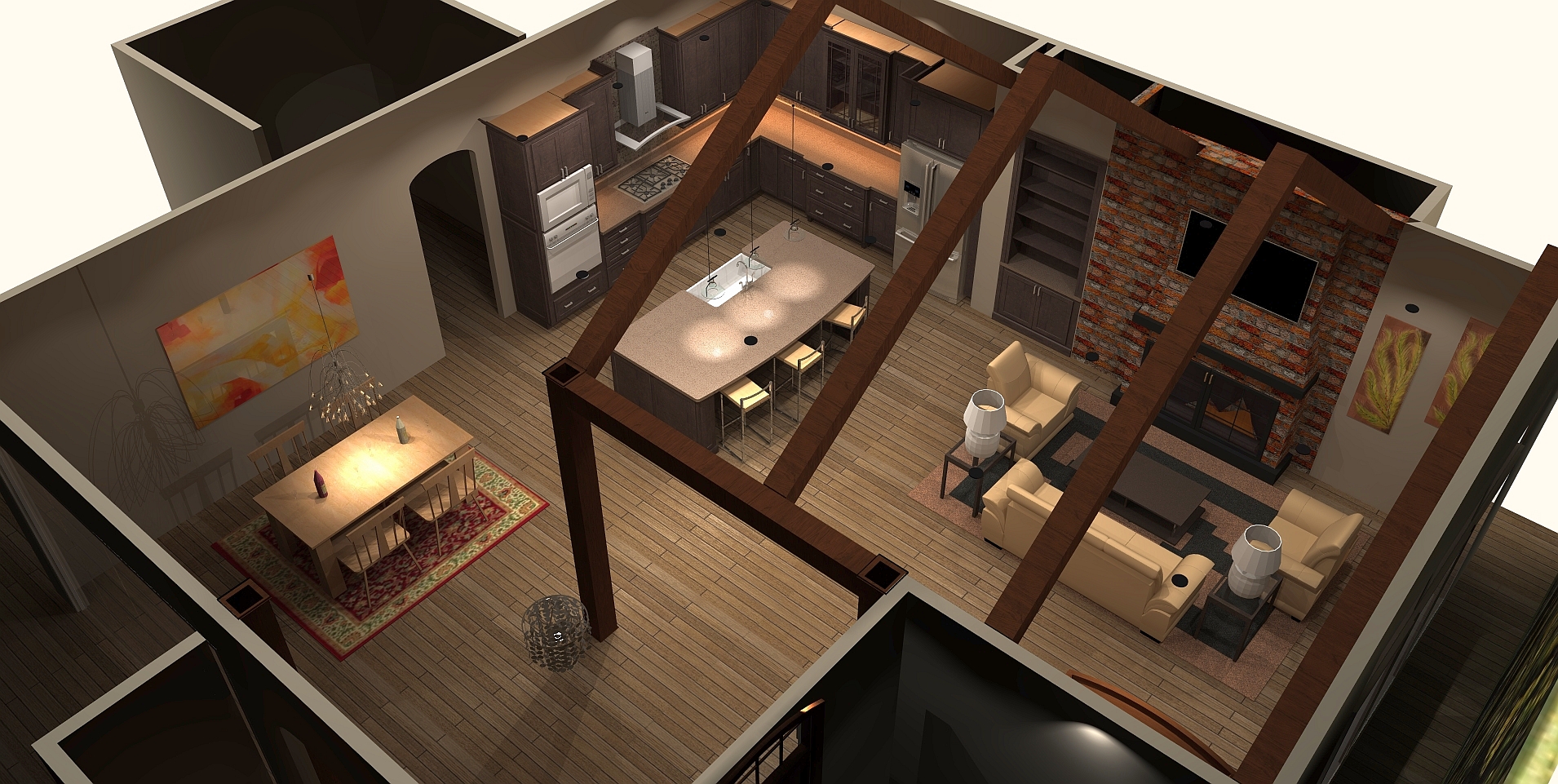

      I have attached a view of a job that I would like a panoramic view of. It has some decoration but not a huge amount. While trying to render the panorama I get  a  “Not enough memory to complete rendering” error.
      I think I read in another thread that the panorama is CPU memory heavy. Is this true? Would increasing Virtual Memory help or is this just more of the 32 bit application problem?
      The Panoramic view is a great tool but I have not had much luck using it unless the job is very simple and un-adorned. I want it for “WOW” factor.
      Also in the attached view. Notice the two lamps. Is there any way to adjust tessellation of objects to get a better render or do I need to search for better objects?
      The whole point of high quality rendering is to try to reach photo-realism and I am having a hard time getting there.

      Hey Kerry,
      First off, that’s an amazing design.  Kudos.  I really like the beams. 🙂
      You are correct in your assumption that renders are CPU heavy But I don’t think that more virtual memory will have much of an effect.  The issue is very definitely related to the memory limitations imposed on the software because it is a 32 bit program.  That’s the bad news.  The good news is that we are working on a 64 bit version of the software that should be released near the end of the year that should have a dramatic impact on how well the software handles stuff like cloud items and the 360 panos.
      For the lamps I’m pretty sure it’s a matter of finding better objects.

      Thanks for the Kudos. I am looking forward to the 64 bit version. Here is a look at the beams with the ceiling attached.
