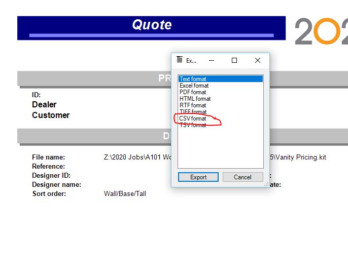

You can also export the report to CSV instead of Excel. (see picture below) That gives you an comma separated text file that you can open in Excel.
I did a test file and found that the totals don’t line up with the same columns as the individual item prices, and it split up some pricing into 2 columns instead of one – for example, one price is supposed to be $1056 but since it is listed on the quote as “1,056” it was placed into 2 columns “1” and “056” in the other. (it thinks the comma in the number is a column delimiter) But at least the formatting is gone and the item description, qty, etc are on the same line as the price, so you can pull this info easily and insert into another spreadsheet and/or add formulas to get discounts and totals.
Using the CSV format also solved an issue I had with the Excel format where the numbers in the quantity and pricing columns were treated as text instead of numbers in formulas.
