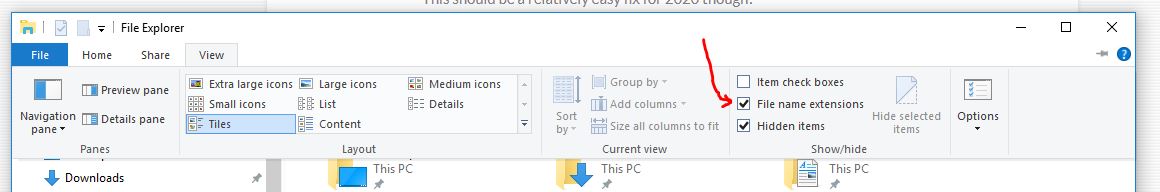

October 15, 2019 at 4:21 pm #253727Neil WilsonParticipant
Hey Dawn,
You seem to know the work arounds so I’ll give you one more thing to try. In file explorer turn on the File Name Extensions in the view tab. This should help but remember, no matter what, if you save any file with a period in the file name and 4 or fewer characters after the period Windows assumes you are entering a file type.
Hope that helps.
