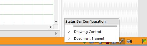

      The camera should be present already. if it isn’t you have 2 options:
      1) Right mouse click on the bottom orange bar and tick the two options that show up (see attached). If this doesn’t work try the next step.

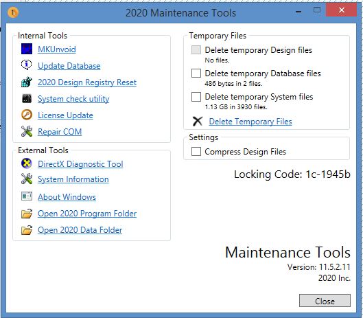

      2) You will have to do a 2020 registry reset – this will lose all your preferences so you have to put them back in after. First go through all your preference settings and note down what they are (I screencap each page and print them out). Now go to All Programs, Design, Tools, Maintenance Tools and click on 2020 Design Registry Reset.
      When you go back into 2020, your camera should be there. Now put your preferences back the way they were.

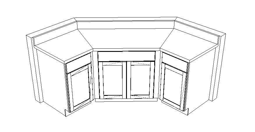

      Here’s what I’m talking about for the bat wing knee wall (see attached)

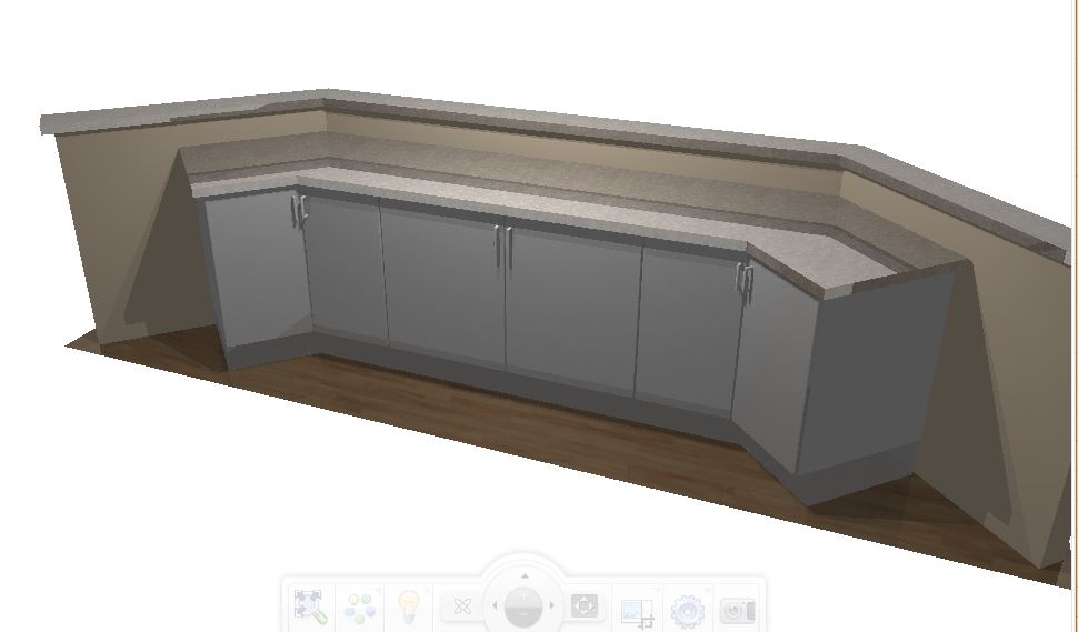

      There’s no really easy way of designing the capping for the wall but there are a couple of ways of going about it one of which you may find easier than the other.
      1) Copy and paste the existing countertop (I use Design/Countertops and Trims NOT the Countertop Wizard) and then lift it to the height of the batwing wall and edit the points that make up the countertop until it matches what you want.
      2) Use a running line to make the shape you want then right click on it, choose Make 3D and make it a countertop. Again, lift it to the height of the wall and adjust the points that make the countertop up until you are happy.
      I used method 1) for the attached picture. I didn’t get the measurements exactly right but it only took me 2-3 mins to get it this far and probably only a few minutes longer to get exactly right.
