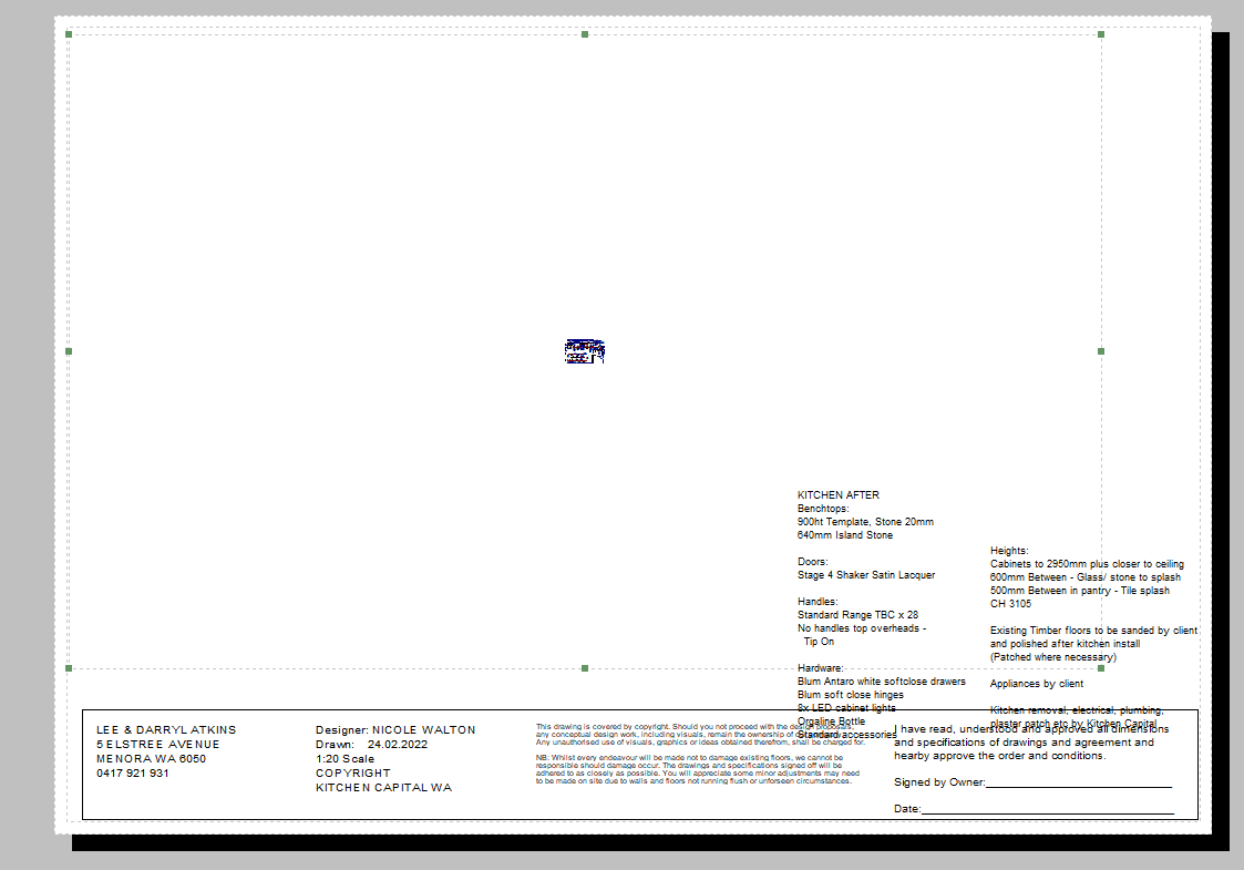

March 8, 2024 at 11:36 pm #437403Nicole WaltonParticipant
I’ve just done the update and now my plans are not coming in to scale on my layout pages! Yep. that’s my floor plan as a tiny dot, supposed to be 1:20 scale.
Support can’t seem to find the answer for that one….
